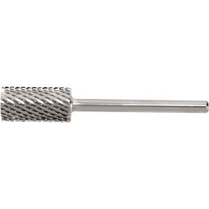

I was wondering if anyone had recommendations for where they get carbide burrs for the Foredom. I was looking at getting a 1/8" x 9/16" Cylinder Square for doing choils after heat treat. Yeah I know I should have done it before heat treat, but customer wants one added. I just figured I could chuck it up in my drill press and add the choil.

Naqtlek, That is a straight 1/8"wide (3mm) round cylinder burr 9/16" long (14mm), with a flat end.
chaotic - I get them from the jewelers supply. I use Stuller, but they are wholesale only. Rio Grande and others should have it.

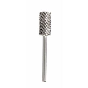

This one is 1/4" by 1/2" with a 3/32 shank:
215652

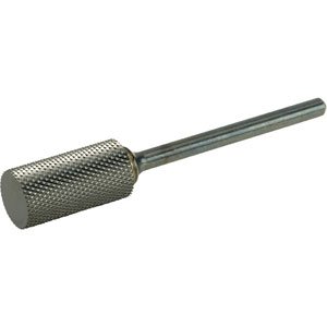

These are finner cut :
303161
