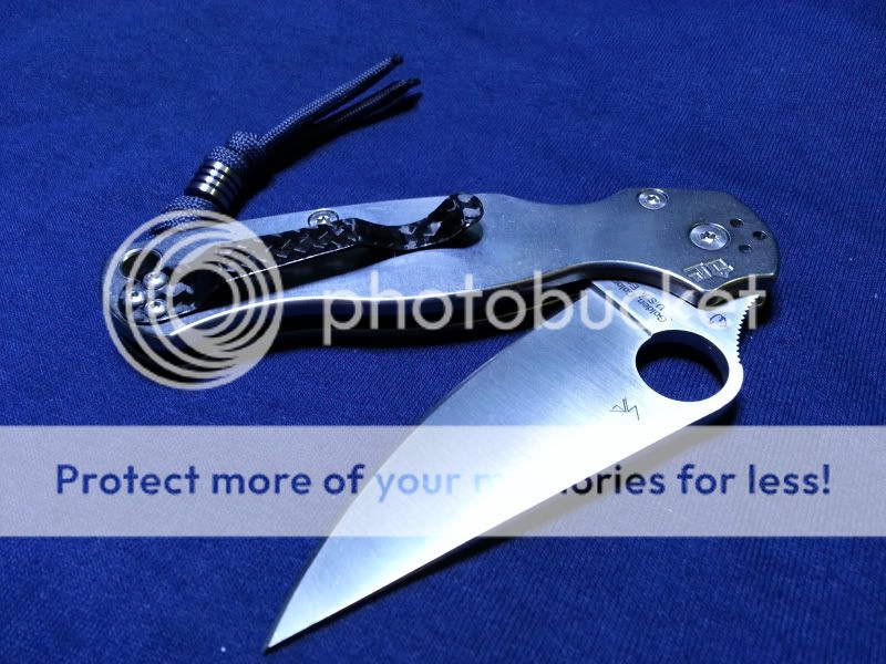

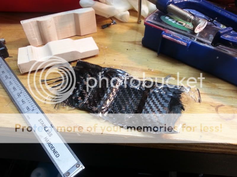

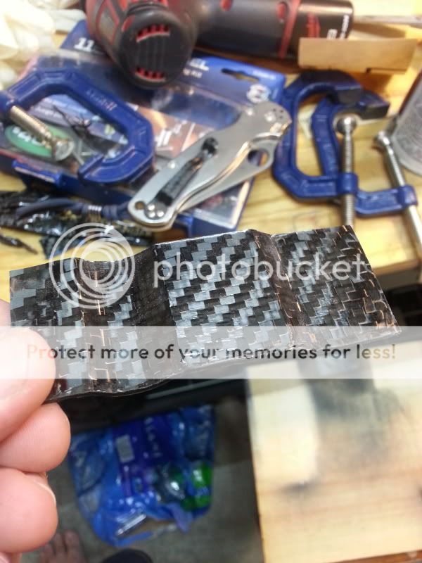

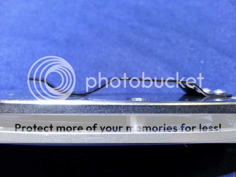

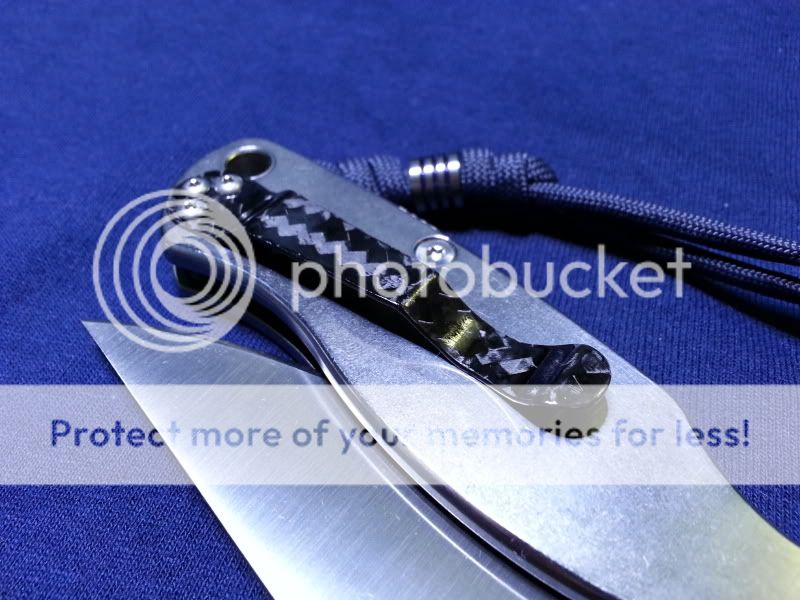

Hi all, just want to show off my latest knife related afternoon project. I know how much this forum loves pictures. It's a 100% real carbon fiber pocket clip for my Spyderco Paramilitary II. It's made from 5 layers of woven carbon fiber laminated together with epoxy resin. This was an idea I've been tossing around for a while now and finally found the time to make it happen. In reality I have no idea how it will perform. It's just a prototype. The retention does not seem to be nearly as stiff as stainless or titanium clips. There really is no advantage other than aesthetics, and it's original. I've got a second batch curing now with 10 layers. I'm curious to see how it will do.
Cheers, Happy 4th!
-Tony

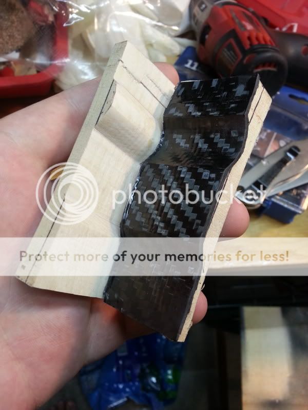

Thanks everyone. I think I'm going to make a new mold with a bit of an angle preload, that way the clip will have a little more pressure against the scale. The material seems to be quite resilient. I just need to get the thickness and layering right.

Is it flexible enough for that?

Yes, thats the problem so far. It's a little too flexible. But depending on how the weave is layered it can be more or less flexible in a particular direction. If it's too stiff I'm worried it would start cracking in the long run. Only time will tell I guess.

I was wondering about that, or about a slight centerline spine (maybe 10 deg on either side) that would give it some additional stiffness along that axis.

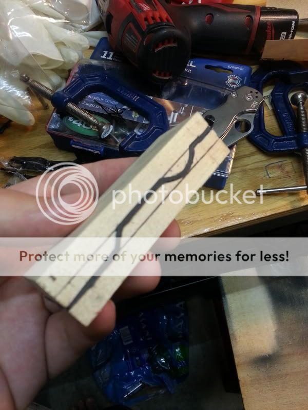

I thought of this too. The trouble is I'm not sure how to make a mold like that. I am able to cut out the profile with a scroll saw.

One relatively easy possibility - not quite as elegant as the canted spine... If you are lining the mold before epoxy, you could (on the base) embed a headless nail (or other wire, to follow the other curves) along the length up into the screw plate - losing the center screw, probably, and route a radius'd trench for it (wire diameter + carbon thickness) in the top piece.
That should provide extra stiffness along that entirety, without requiring as many layers, or risking too much bend/cracking at the screw plate/clip junction.
