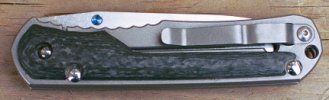

Wow Barry, nice job! Are the scales textured or does it just look that way?
(Barry's Sebbie)
attachment.php
Thanks,
It's actually very textured. I formed the shape of the overlays first, then I sanded with a spindle sander and a dremel to achieve my overall shape. Then I took a rotozip carbide cutter designed to cut tile (very aggressive) and ran it over the overlays to achieve a terraced effect. Net result is a very tactile grip. Plus I used 1/8" overlays so my net thickness is 3/4", almost identical to my Strider AR. I got big hands==I can't seem to put this one down:D

that looks awesome sir. May I ask what you used to attach the CF to the Ti slabs ? And did you have to do anything to the TI before hand ?
that is one I wish CRK would make...CF rocks !
excellent job !

I used a semi-permanant adhesive. I have had it in place for one month so far and I have used the knife daily, sometimes to extreme hand help pressure. I did nothing to the ti slabs before hand, but I have been known to refinish ti slabs with a ceramic blasting compound which leaves a very Carson-like finish to the handles. The adhesive (and carbon fiber) ought to be able to be removed, if one wanted, leaving the knife in it's original state.
It was a fun project:)
Any one wanting to duplicate this effect, let me know!:)

Another shot of Barry's baby.
