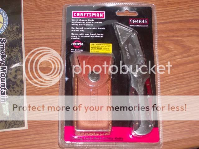

This is the best folding box cutter I have ever used, all stainless. Craftsmen lockback can be had at department store for +/-10 bucks.
