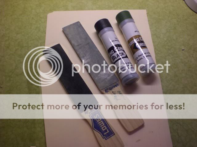

I use manila-folder cardboard strops, loaded with several different compounds.
Get a large (5 gal) paint stirrer from Lowes/HomeDepot and glue a 7" piece of manila-folder cardboard to it, using white glue.
Allow to dry, then moisten the cardboard with lighter fluid and smear on the compound. In a few minutes, after the lighterfluid evaporates, you're good to go.
Here's a pic, using Harbor Freight Black(coarse) and Green (fine) compounds:
