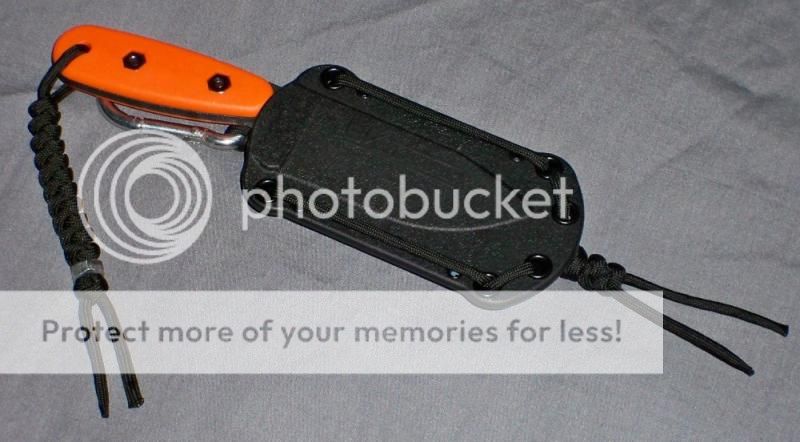

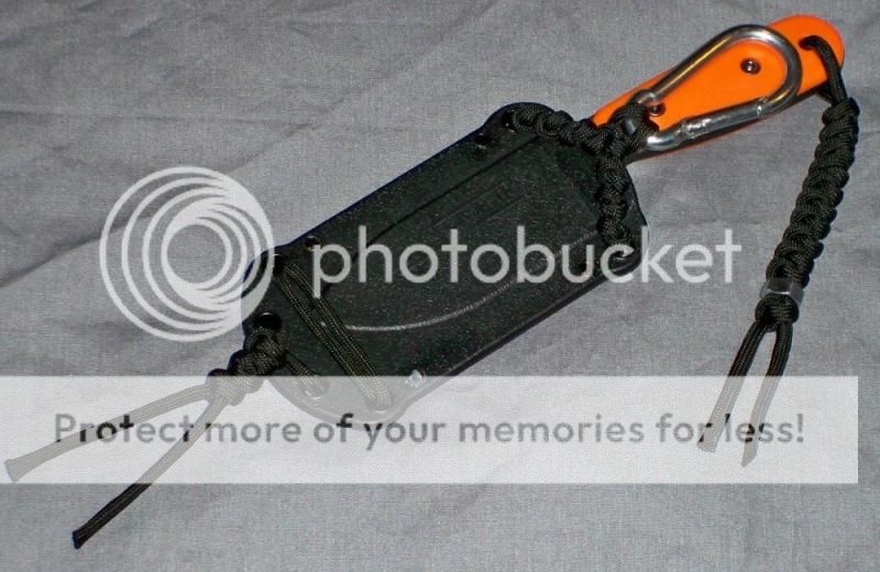

This is the rig I made for the BK14.
Pros: cheap, easy to make, easy to undo, allows the knife to hang in a comfortable manner.
Cons: the paracord stretches so there's not enough tension to allow for easy resheathing of the knife. Even when it's pulled extra tight it still stretches and I don't know what to do about it.

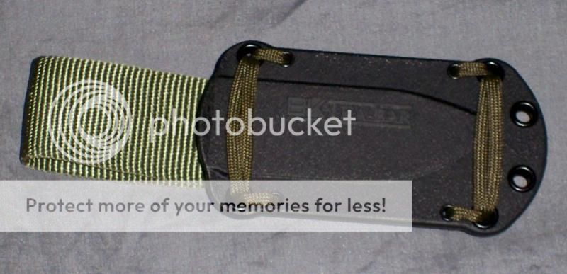

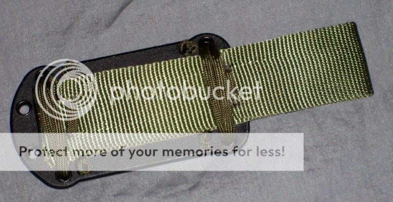

Well how about this rig?
Similar to the BK2 and the carrying sheath on various Cold Steel knives.
PRO TIP...
Boil water... insert sheath with paracord attached... boil for a little bit... remove from water, paracord will shrink up. Partial problem solved.
