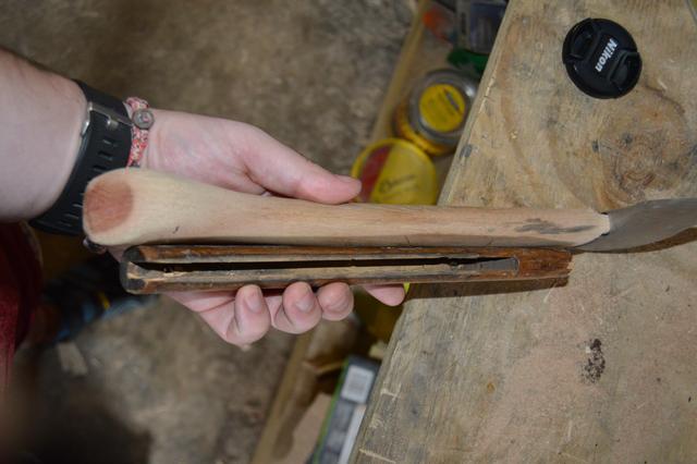

Need some help on a hatchet i'm putting a new handle on. The old handle had a crack that started where the blade guard had a rivet went through the old handle.

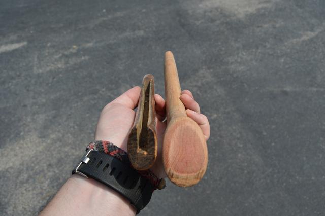

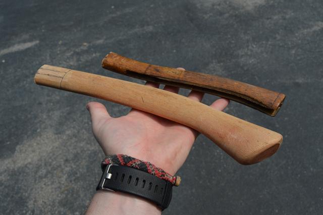

New vs old, I've thinned it down a bit before fitting the hatchet to it, but I'm struggling with how to remake the "trench" for the guard. I also wanted the new handle to be slightly longer, as I'd like to avoid having the trench terminate at the end of the handle, weakening the wood further.
This old handle was cut from a cracked 22" handle from a Michigan axe I got from my grandpa, I figured I would save what I could from it. Thinking of thinning down the swell a bit, but not too much.

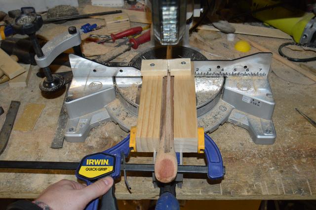

Clamp it between to 2x6s. Add a filler block at the top of the 2x6s that is the same thickness as the haft. Then run screws thru the 2x6s above the haft and below block - creating the clamping action. Maybe secure the block to one of the 2x6s.
Then take your whole jig with the haft in it to your table saw or router shaping table.

Going with the jig idea, I used what I had around to be able to make a channel with my miter saw. I realized putting the guard up to it that the bottom will have to have some extra taken out so you can get a finger under the actual guard to pull it out, so I figured this would work. Sadly Survivor45 I don't have friends (that live close with equipment) that can help, but I do have some chisels and a dremel that I will be using to finish the process.
The miter saw and 10 minutes with a chisel got me more than halfway there, will continue later this week!

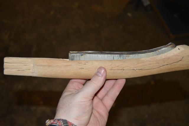

I have finished carving the channel, and my next step is fixing the guard into the handle. It was fastened in there originally with a small bolt/nut at the top, and riveted with a small piece of brass at the bottom, both of which went completely through the handle. I would like to avoid that, so I am thinking of using epoxy to set it in, with maybe some half inch screws. My #6 screws are too large, so I may have to find some other option.
Any objections to these ideas or other suggestions? I can post pictures tomorrow of the guard if needed.
