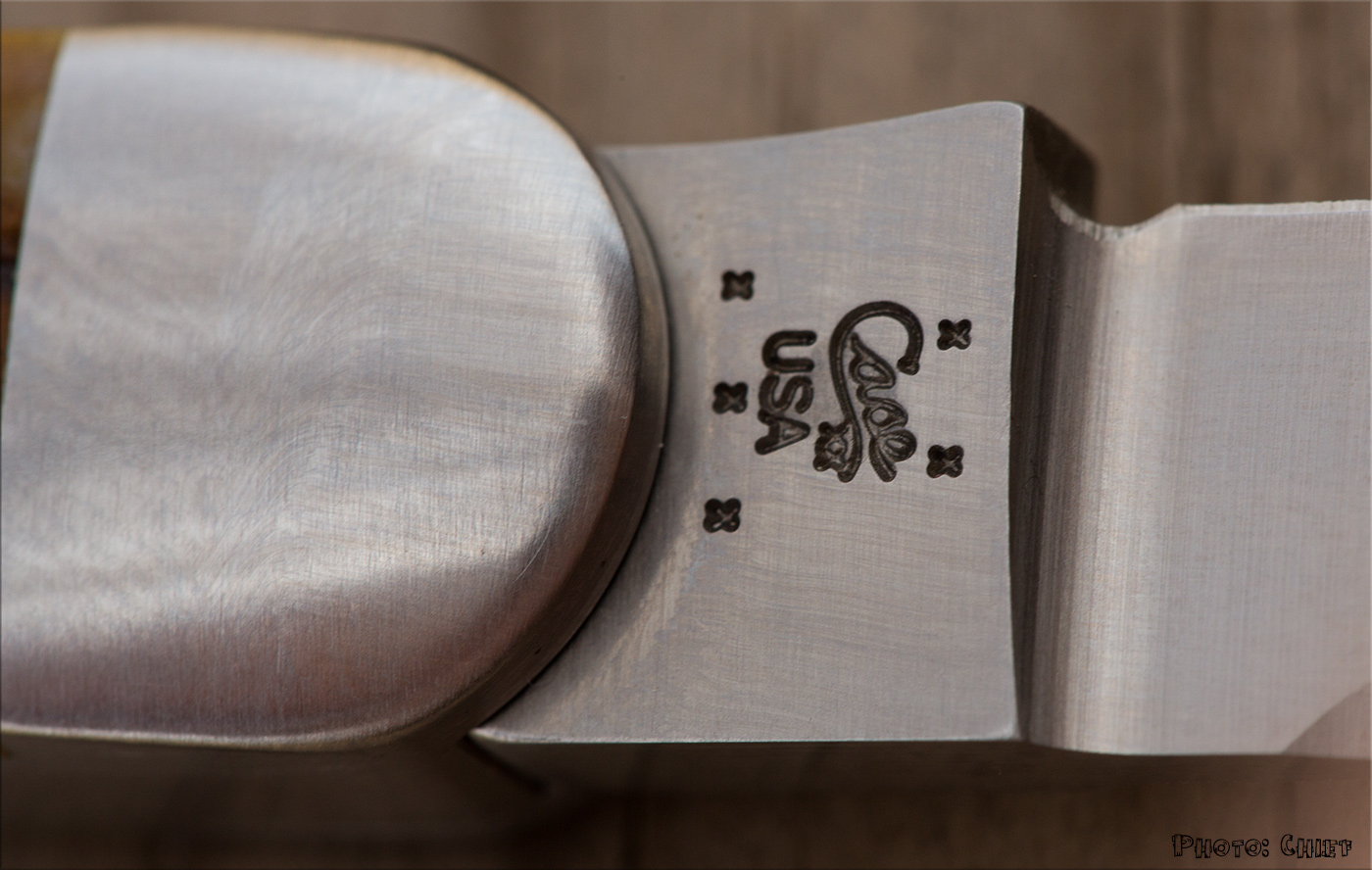

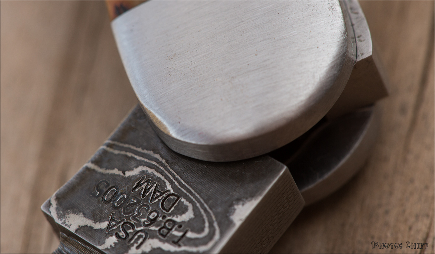

My Damascus whittler arrived yesterday and has the same lock issue, nearly impossible to unlock. In comparison, my original version's lock is butter smooth. Worked the lock on the Damascus for over an hour and gave up. Fit and finish of the bolsters on the Damascus (second pic with multiple bevels) is not on the same level as the originals (third pic) ... not even close. Sad to see such a lack of QC by both Case and the Master Dealer I purchased from on such an expensive knife.
I'm afraid I'm inclined to agree with Chief about the QC on this one. I have a number of the older collab models and they seem to be assembled a bit better. The snap on the blades of this one doesn't sing the way my Norfolks or Dogleg does.
Unlike a regular slipjoint, where spring tension is unlikely to alter much over time, I wonder if this is not an issue of excessive friction where the notch in the tang receives the "key" on the spring. I imagine the damascus might have a bit rougher surface that needs to wear in a little. Be sure to really drench that area (kind of behind the joint) and maybe try a dry lube like graphite in there. The notch should be fully exposed when the knife is closed.
The error here may very well have been using the same tolerances for the ats34 and the damascus construction, when the damascus could benefit from a tad more slop (or polishing or both) because of the rough surface (compare the spines of the blades in the above pic).

If a defect needs 3x magnification to see clearly, then it maybe is just a side effect of being hand finished by fallible humans. :)
The bone on those are quite awesome. I'd really like to see Case step up their game on their production knives.
