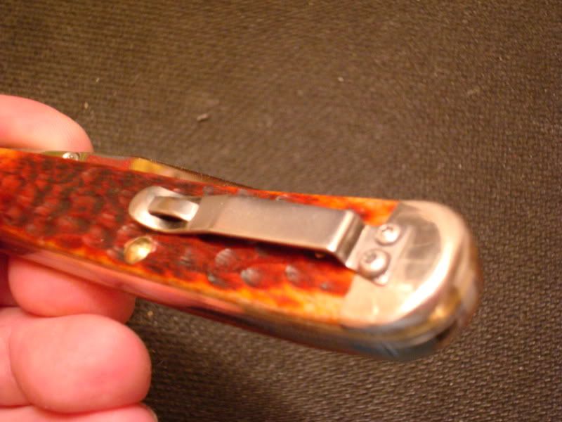

He probably means all the Trapperlocks he has handled. I love my Chesnut Trapperlock, I have been carrying it for a couple of weeks now. Iput a clip on mine (tip up). It makes a perfet EDC for me now!

I'd love to see some pics of what your trapperlock looks like with the clip.
I have been thinking of getting a Trapperlock, but the lack of a clip deterred me. I would love to see pics, and would like to know:
--where did you get the clip?
--what is it called?
--how do you attach it?
--or did someone else do it custom?
Just curious; interested in doing the same.
Thanks.

I did a crappy job.... but I'll post pics tomorrow.

Here is my clip pictures. Fit and finish suck, but form and function is awsome for this knife IMO. I STUPIDLY used a tiny carbide center drill and the tip broke off it the bolster. I had to tap one hole larger than the other by the time I dug the piece of carbide out. I should have used a High speed steel center dill, Or (and more to the point, been more car full). I used 2-56 torx screws I robed from a kersaw knife.
I held the knife open in a vise. I cut a piece of thick plastic and contoured it to the inside of the knife and put the spine of the knife on the back jaw. I put same height parallels under each bolster for the down force of the drill.
I used a clip from a flashlight I had.
