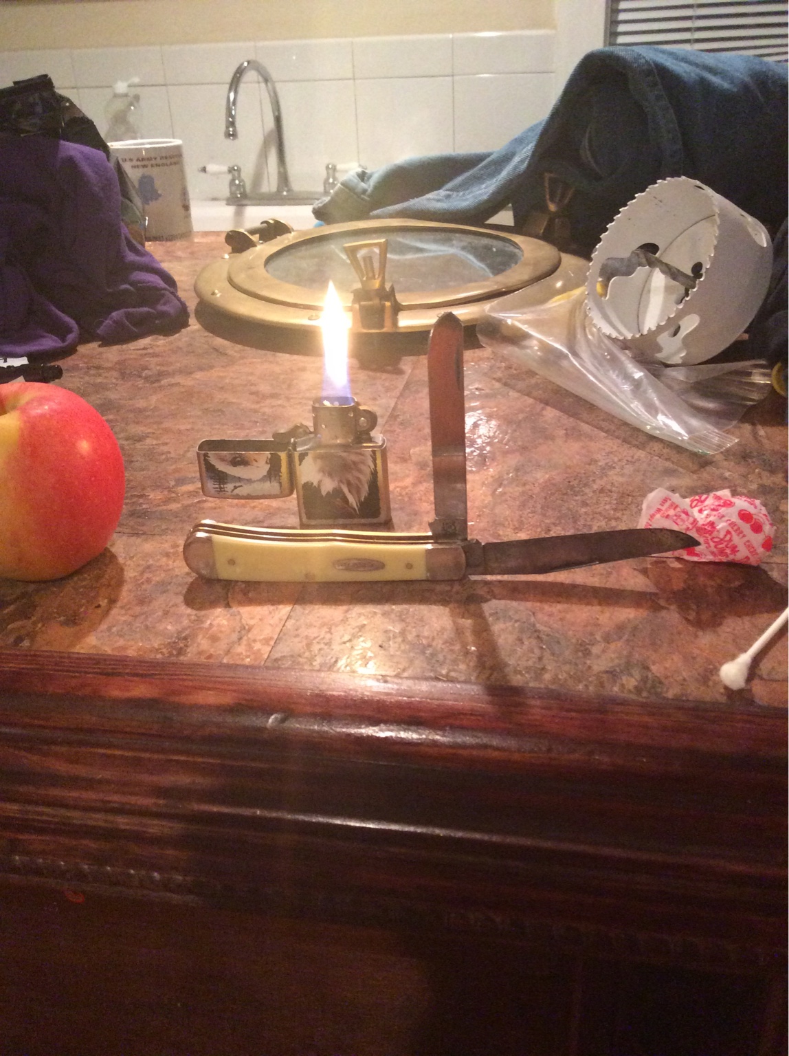

That maybe what I do. I literally can not leave the house without my yellow handled cv trapper. If I do leave it to carry something else I feel lost all day
My edc ever morning
