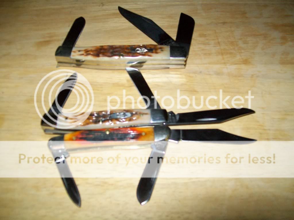

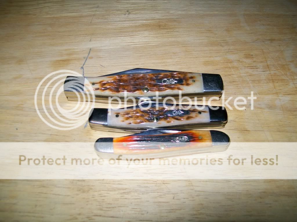

But on to the topic, I got home from dinner and giving my grandfather his new companion, and I compared the Medium CV Stockman (that I bought for myself as my grandfather's new knife's brother) to my Case Medium Tru-Sharp Stockman.
There is actually a size difference. The CV Stockman is about 1/4-3/8" longer then the SS Tru-Sharp Medium Stockman.
Now, I know what some of you guys are thinking, and the answer is YES-I am very sure that the Tru-Sharp knife is a Medium model and not a Small model.
Now, even though I am very sure, I am open to argument, so I'm not gonna say that I am right here.
My question is, what's with the size difference?
Here are some pictures so you guys can see what I am talking about.
There is a Large CV Stockman on top for even more size comparison:
Sorry about the lighting, but its night here and Im no photographer.
You'll find each of those has a different model number. From top to bottom that's probably a 6375. a 63032, and a 63087. There's also a 6344 that looks the same as the 63032 but is only 3 1/4" long - also called a medium stockman. Unfortunately, Case and/or its dealers have decided to call about half the pattern inventory a "medium stockman" - there are about 4 other pattern numbers that are lumped under medium stockman also - from 3 1/4" to 3 7/8" (though I'd consider the 3 7/8" a standard stockman) - from "square" bolstered serpentine, to round bolstered serpentine, to straight equal end, to humpback equal end. So yeah, "medium stockman" is a fairly useless term with Case knives -- you really need to get specific with the pattern number to know what you've got (or what you'll be getting).
zerogee hit the nail on the head. There's several "medium" stockmans in Case's line, which is misleading, confusing, and doesn't "jive" with other companies' descriptions (although to be fair few have the variety of Case). For example, the 6344 "medium" stockman is 3.25" closed. Exactly the same closed length as Queen's "small" stockman. Case's "small" stockman is smaller than most any other company makes, so I suppose it's all relative.
You do really have to pay attention to the pattern number and the actual size. For example, the Dark Red Bone Medium Stockman CV (6344) and the Chestnut Bone Medium Stockman CV (63032) look like the same knife. Both are "medium", both have a pen blade rather than a spay, etc. But the size is very different. The 3/8" difference in closed length might sound small on paper, but this translates to a significant difference. The 6344 is smallish, slim, almost a pen knife, with light pulls on the thinish, flexible blades. The 63032 is wider, thicker, with stronger pulls and more robust blades. Even a Buck 303 or Schrade 34OT make the 6344 seem small and dainty.

Great looking knives.And good on you for thinking of grandpa!Yea,model numbers are the thing with Case.The last two describe the pattern.Well sometimes three.First,the handle material,second, number of blades.Enjoy!:D
I've learned to take Case's size descriptions with a grain of salt (sometime's a whole shaker's worth). I bought a 5344 'Medium' stag stockman a while back, and was shocked at how small it actually was. To make matters worse, at the time, both Case and many retailers had actually posted inaccurate size specs on it (listed as bigger than it actually was, by 1/4" or so).
So, as zerogee, Planterz and Seals have all mentioned, look only at the pattern number for comparison's sake. If the pattern numbers aren't the same, it's just like comparing apples to oranges (or, with the size difference, grapefruits?).

To these can also be added:
63090.....3 3/8" round bolsters, straight equal end
63046.....3 5/8" round bolsters, humpback equal end
Though technically both of these are cattle knives, not stockman patterns, both are always called medium stockman or stockman by Case and their dealers.
