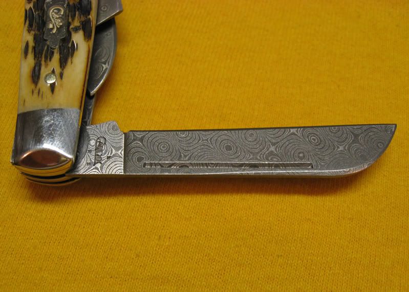

Damascus goes well with Peanuts. The two single blade peanuts on top are older ones with a different kind of damascus than the two blade peanuts on the bottom with the raindrop.
It gets sharp too. One of these bit me and drew a little blood while I was posing them for the picture.:D

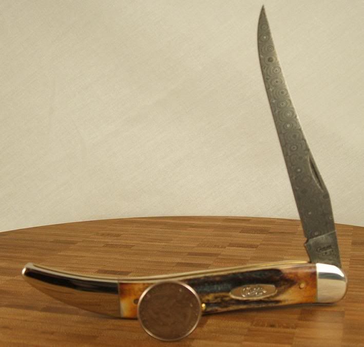

Here's a stag & damascus Case Peanut I was fortunate enough to receive as a gift from my buddy Thomason:

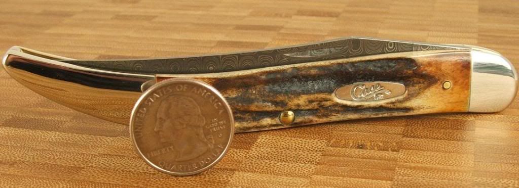

I like the new damascus. It makes my toothpick prettier. :)
