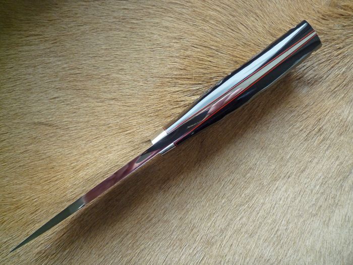

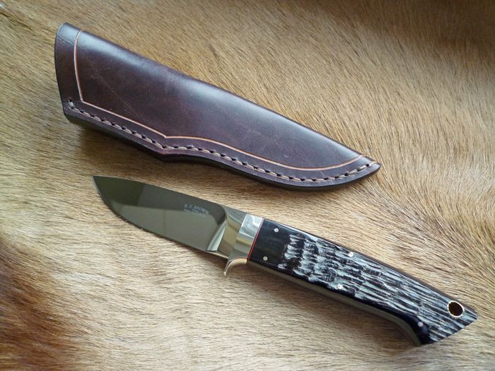

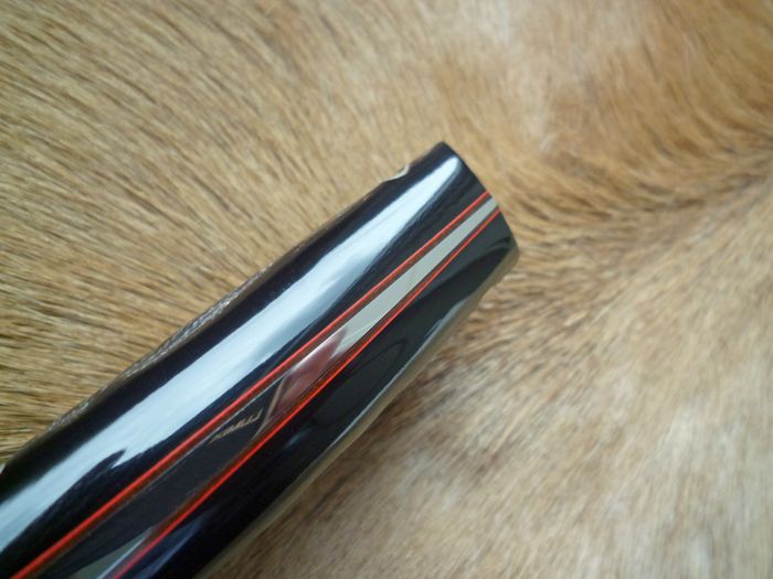

A 1980's Buffalo drop-point hunter by the late great Rob Brown
I have another with Buffalo handle and that too has been very stable indeed.
