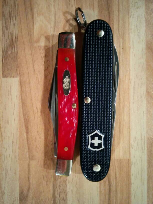

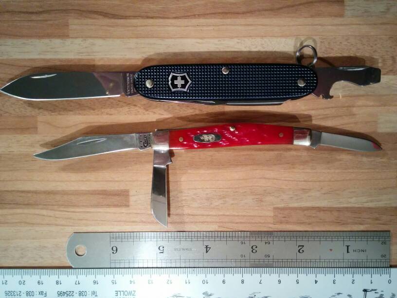

I tried to shoot some comparison shots, but the artificial lightning produces some horrible colors [emoji4]
Anyway, here are some pics of a case 6344 (smallest medium stockman at 3,25 inch) and a Pioneer. The case looks much better in real life [emoji6]
