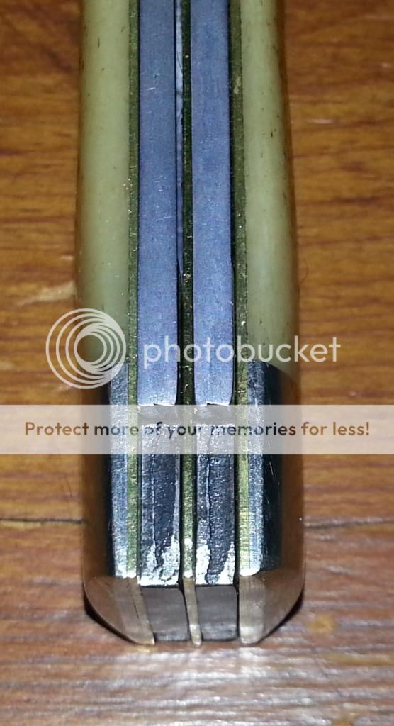

I don’t have a lot of experience with traditional folders, so I have a question for those of you who do. I just purchased a new Case Slimline Trapper, model 61048 SS. As soon as I opened the box, I noticed a few obvious problems with the knife. My question to you guys is; are the problems I noticed acceptable in a non-custom knife? If not, what would you do about them? (Problems identified below.)
The most notable problem to me, is the big gouge in the back square area of the tang. Also, the blade isn’t centered when closed, the end of the spring is not square, and blade and spring aren’t flush when the blade is fully opened.

Yes, Case messed up on that one. Send it back to the dealer for replacement or to Case. As Mark mentioned, the other problems are minor, but that tang is a deal breaker.
I have to agree, send it back. That large burr on the tang is causing the back spring to stick up above the spine when the knife is open.
Thanks for the prompt response guys. I wonder how they even made that gouge? I'll contact the Dealer and Case to see about returning it.
I respectfully disagree with the other posters, practically every slip joint I own has something like that 'gouge' in it, it has come up before in some other thread, pretty sure it is just an artiact of the manufacture process. Otherwise, fit and finish issues are cosmetic, but fairly standard for case, I don't think it is grounds to send it back.

That is kind of a value judgement, Cory. If the knife were a GEC or even a Queen or Case, I would not be happy. But that is just me.
just pulled my 82 dixie stockman out of my pocket and all three blade tangs have that bur. went and looked at my other GECs and Queens and they all have it to some extent. I think i remember a dealer mention one time that its from stamping the blades out or something of that nature. Could be wrong but i do remember them saying it was normal.
I just got my Case Slimline Trapper out and it looks a lot like yours, even down to the "gouge". I have never looked at it that closely before. It's just an artifact left over from when the blade blank was stamped out, and it just didn't get polished flat during finishing.
I've got a Case stockman with me today and all three of the blades on it have similar marks. It's just the way they make the blades.
The backspring on mine is mostly flush when open, though. Of the issues you mentioned, a proud backspring is the only one that would bother me, but only if it were significant. I have other knives with slightly proud backsprings (worst is a Queen) but I still carry and use them.

That tang looks weird, it may be the pic but it also looks warped and it looks like the backspring is narrower than the tang. Is it a gouge or a ridge? The way the backspring is sticking up it looks like a ridge. I just pulled out a one dot slim trapper the tangs are perfect and the spring is flush open and closed. Maybe I've been lucky but I just looked at 10 gec tangs All are cleanly cut, no rough ones. I'd send it back in a NY second.

Those machine markings on the tang are pretty common on many brands of Trad knife, they should not interfere with action.

^^This. It's as common as traditional pocketknives themselves, and has no impact on function. I've seen it in scores of knives for years, across many brands; the 'defect' area is always recessed below the plane of the polished areas. In the OP's example (pic below), I'm not seeing it raising the spring above the liners either; the pivot looks more 'underbladed' to me, with the spring (appearing to be) flush to the liners and the blade spine below that plane. Nothing to do with the rough finish on the tang, in other words, but with the pivot's location relative to the blade spine.
(5th pic from OP's posted examples):
It's OK to not like the look of it, and Case (or the dealer) might be willing to swap it for a cleaner-looking knife. But functionally, it has no real impact at all.

Actually mine is underbladed as well. I believe that is how the knife is designed, but I only have my one sample to go by. Not all knives are designed to have the spring and spine flush.
