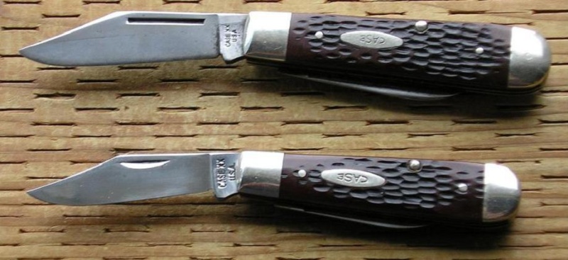

Case tested knife pattern & handle ??
Case had a 62031 1/2 pattern jack with a clip blade (w/long pull) and pen blade. The one guide reference I can find lists it at 3-3/4" closed. I'm pretty sure the sizes varied a bit over the years, so a 1/8" variance in the closed length might not be significant. The guide book* I refer to shows there was a version prior to 1940 (Tested era) with green bone and a long pull. And the bomb shield I assume would be pretty rare - most any I see online have the regular Case oval shield.

6231 1/2 is 3 3/4", thats probably what it is.
The handles are green bone.
Flush the pivot with WD40 and oil it. Its might just be gummed up.
3 5/8 " closed
I'm not seeing any barehead jacks that size in the AAPK Case pattern numbers reference I linked above.
The '024 pattern is listed on that reference as 3" closed, although I've seen examples for sale listed as 3" and others listed as 3.5" (close to 3 5/8"). I have no explanation for those discrepancies.
- GT
The knife pictured (in question) appears to be a 3 3/8" 6202 1/2 Swell End Jack. Note it is bareheaded (no end cap). I do not have one.
This is a 3 1/4" 6235 1/2 Swell End Jack. Note the end caps.
This is a 3 3/4" 6231 1/2 Swell End Jack. Note it also has end caps.
Here are the 35 and 31 together
Hope this helps. .

Not a Case expert, or any where close, but just paged through "Collecting Case Knives" by Steve Pfeiffer and the 31 pattern is the closest, and it was made in a bareheaded version.
The jigging does not look like any Case jigging I have ever handled or seen in pictures. The individual jigs are too consistently oval and the ends are more pointed than any Case jigging I have seen. Just my opinion.
Could be the jigging is worn from use and carry. Regardless, it's a nice old knife.
The knife may have been "worked on" at some point. That would explain the why the main blade is pretty much full while the rest of the knife shows that it has been used and carried a lot. A replacement blade would also explain why it doesn't have any action in it.
