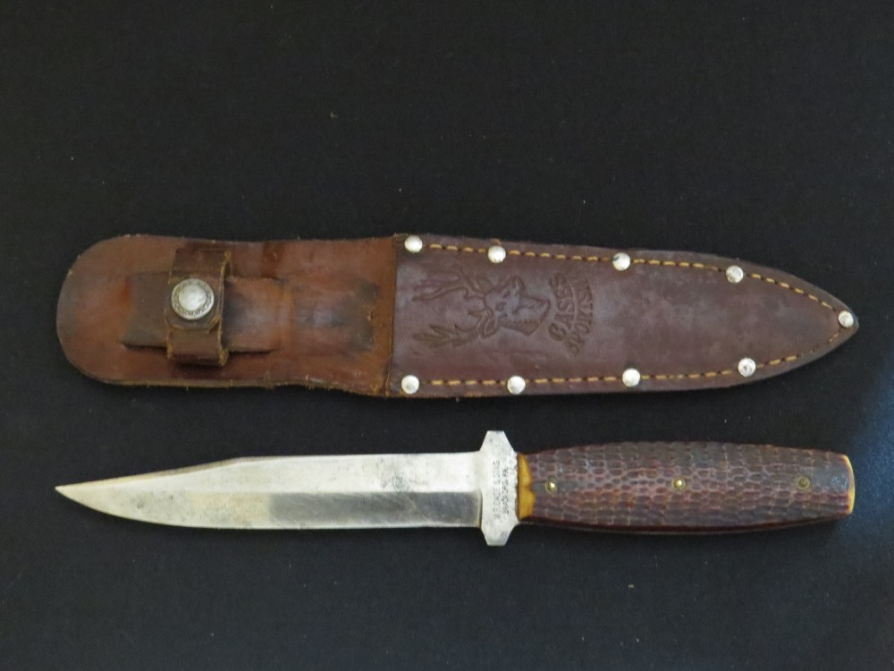

I have had this knife over 10 years now. I bought it from the guy who said it was used in world war II and referred to it as a pig sticker. I can't find very much about this blade profile. In looking at the tang stamp, looks like it might be produced pre- 1940. I just want some more information so I know what I have, thanks very much!

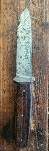

A collecting guide* I have includes one pattern that vaguely resembles the blade grind (a sabre grind) with that integral 'guard'. Pattern numbers start either with '62' or '63' with variations of 62-5, 62-6, 63-5, 63-6. I'm assuming the -5 or -6 are referencing blade length in inches. All produced in mid/late '30s (Tested XX era) thru late '40s (XX era). But all the blades shown in the guide were apparently clip profile in their original form. My first thought when looking at your photo was to wonder if the blade profile had at some time been reground, perhaps to make something useful from a blade with a broken tip, and maybe rehandled as well. All the originals were apparently in bone handles. I searched the web on some of the pattern numbers, and found an old SOLD listing of one of them, with a photo below from that listing (named as pattern# 62-5 in that listing). The guide I mentioned doesn't include anything else with that integral guard in the blade grind. This is the only one that looks anything close to what you've got.
* - "Official Price Guide to Collector Knives", Fourteenth Edition, by C. Houston Price (2004)
(photo below is from a SOLD vendor listing on the web)

In Sargent's 7th book, it shows 4 different blade profiles of of pig-stickers, but with stag handles. 562-5, 562-6, 563-5, 563-6. But a few pages later is this text.
"Pig sticker in wood: The wood-handled “pig sticker” exhibited a double-edged dagger style six-inch blade and was listed as a 162-6 in the January 1, 1934 price list and, by the time of the issuance of the 1941 Case catalog, was listed as a 562. Later, it was designated as a 562-6 in catalog #66 with the 562-6 pattern number remaining until it was last listed in the December 1, 1959 price list. Surprisingly, this pattern was routinely listed in Case catalogs in the household cutlery section—quite a piece of cutlery for the kitchen. This knife was also produced with a single edge, but the pattern number of this variation is not known."
