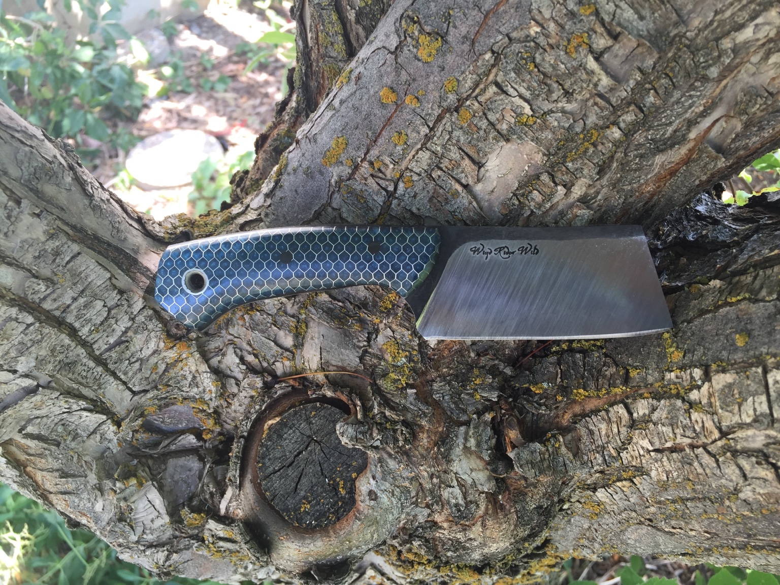

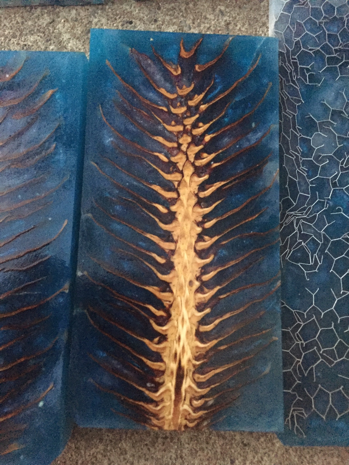

Thanks guys. So a true stabilizing is a PITA? I really am looking into casting. To make stuff like this
. Or like you said, pinecone, corncob, or whatever I think would look cool. :) Would a pressure pot be good for that? Or does it still need to be stabilized afterwards. Alumilite is what I'm looking at for the resin, just wanted to see what else would work, or not.

what is the honeycomb material? thats awesome!
