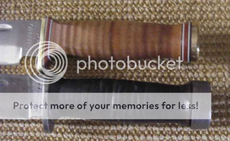

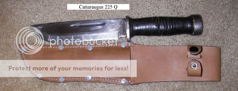

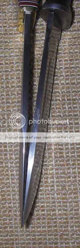

Hi Ivan. They are very good working knives. I have several of them. A firm called Allied sells sheaths for them on Ebay. I also did a side by side comparison of one of them next to the Ontario wannabe elsewhere in Bladeforums. Suffice to say that the Ontario knife may have been given the same name, but it is only a pale shadow of the real thing. The Ontario knife may be stainless, but it is much flimsier. Here are some photos.
Ontario on the left, genuine article on the right
ibid
ibid
Ontario on top
The Allied sheath

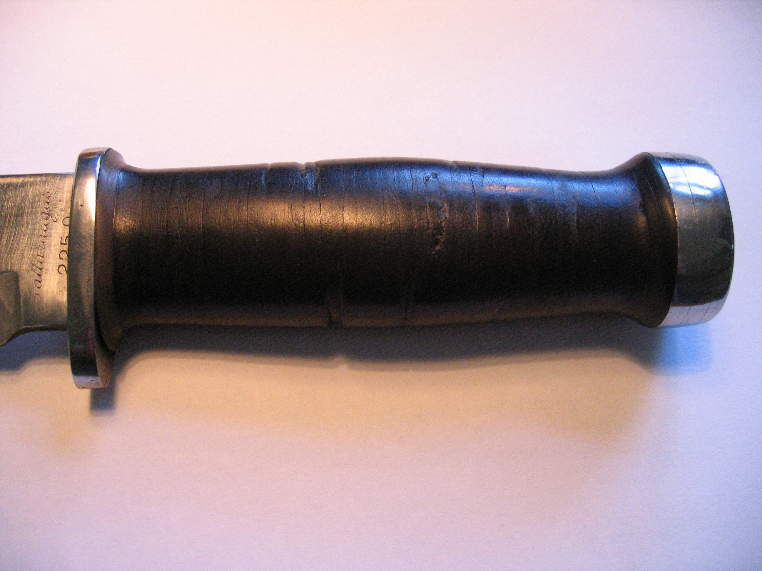

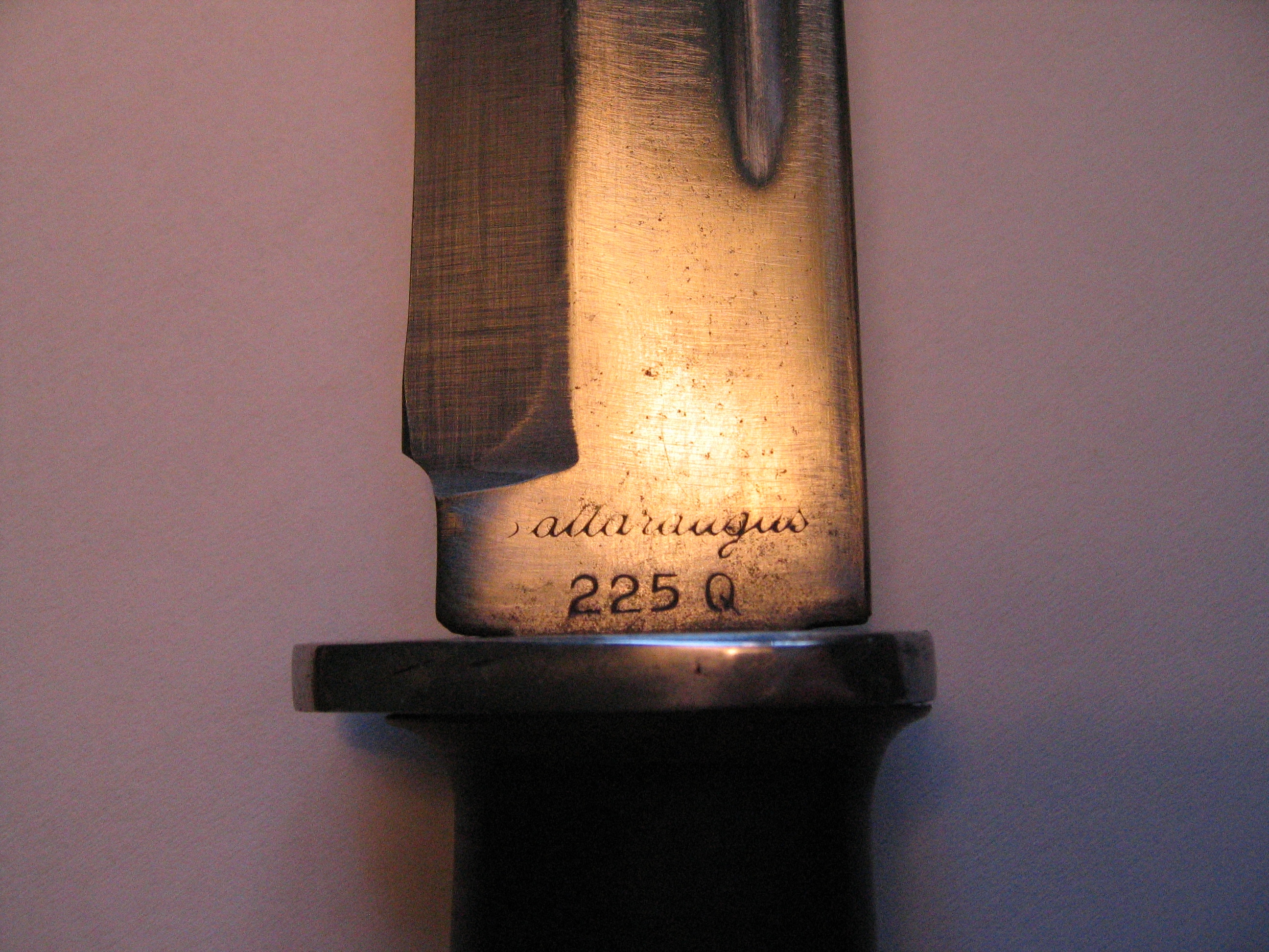

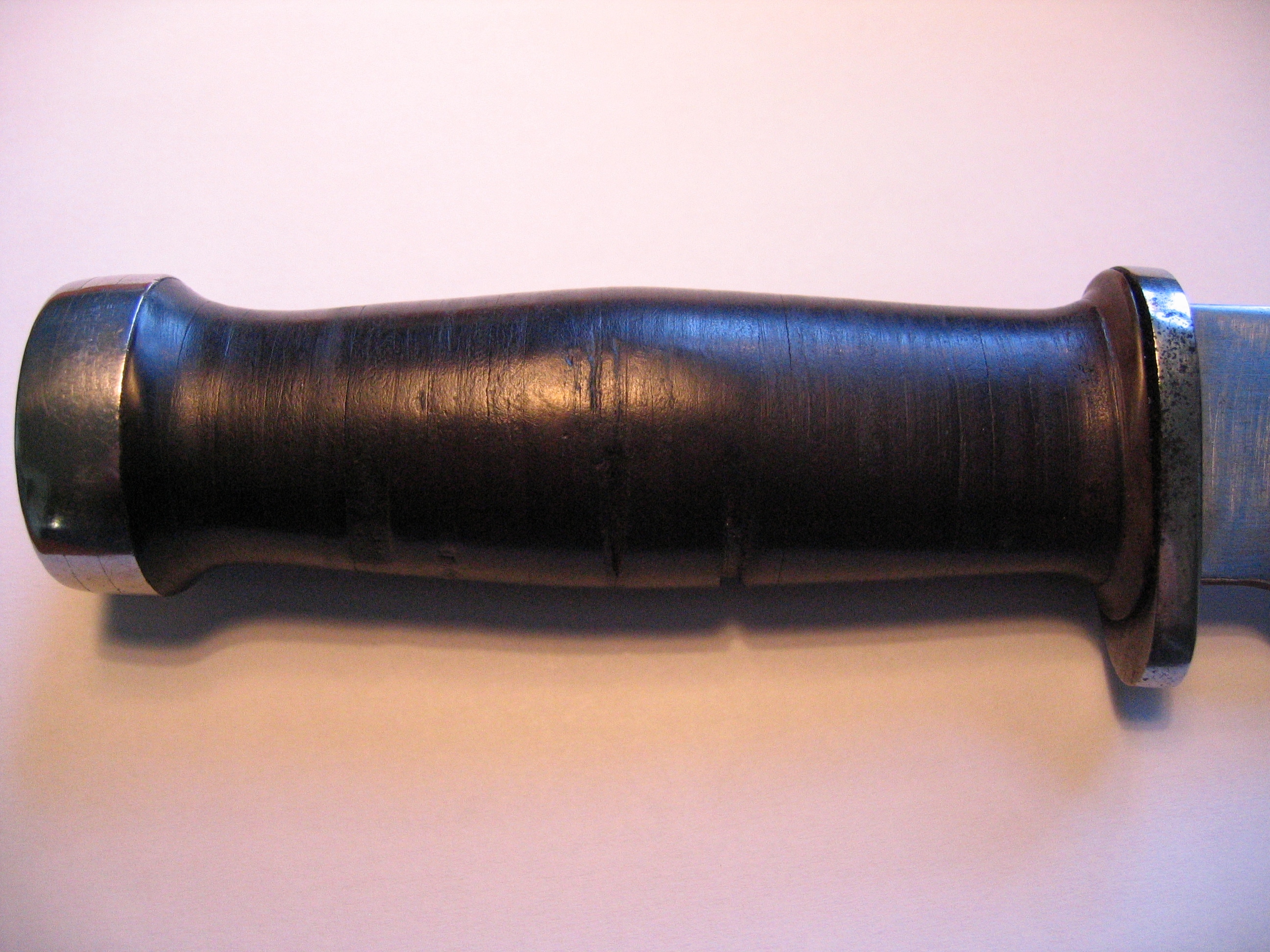

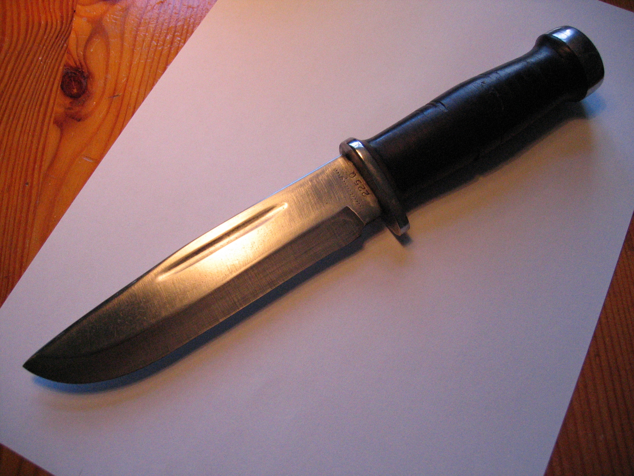

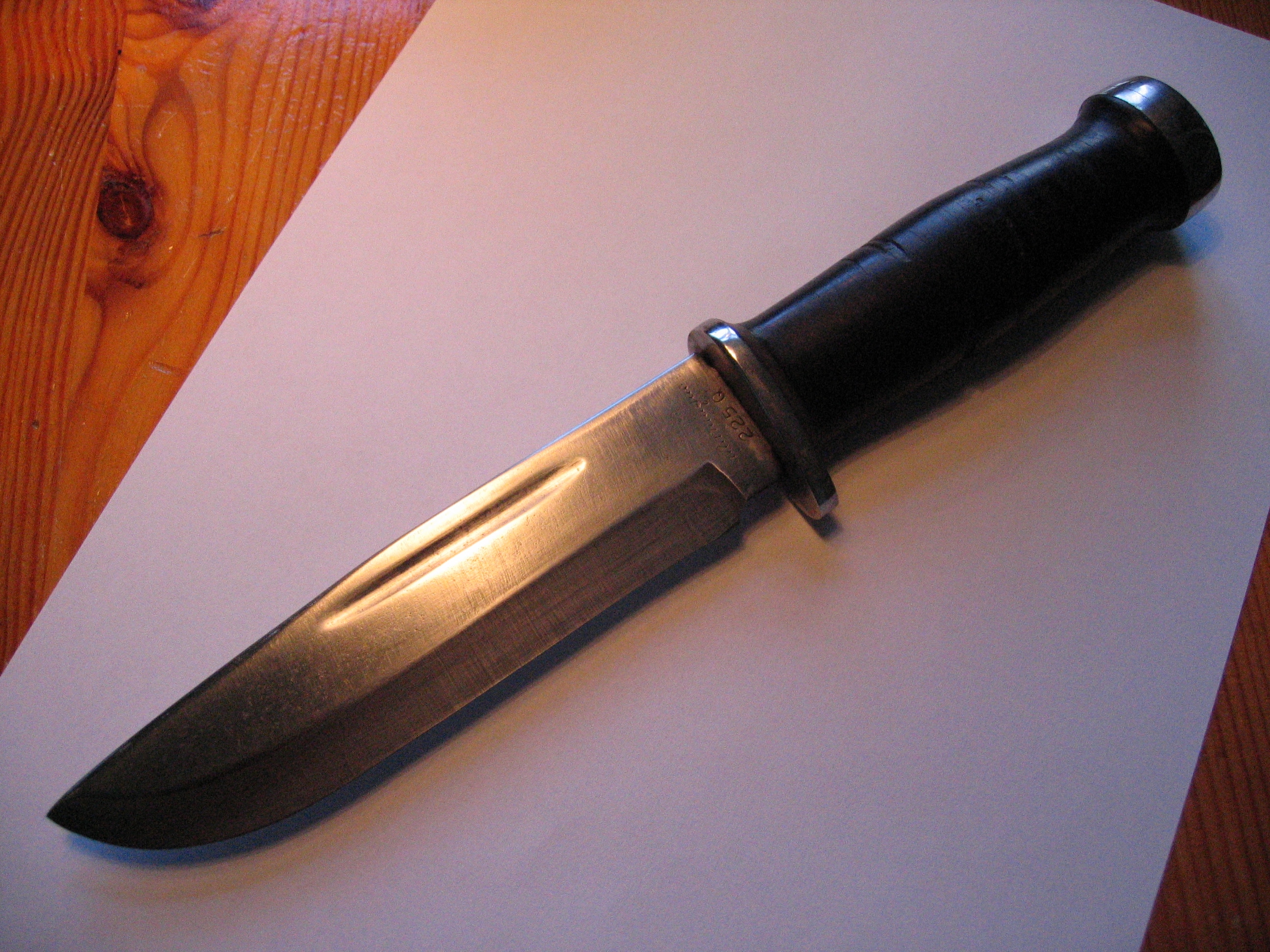

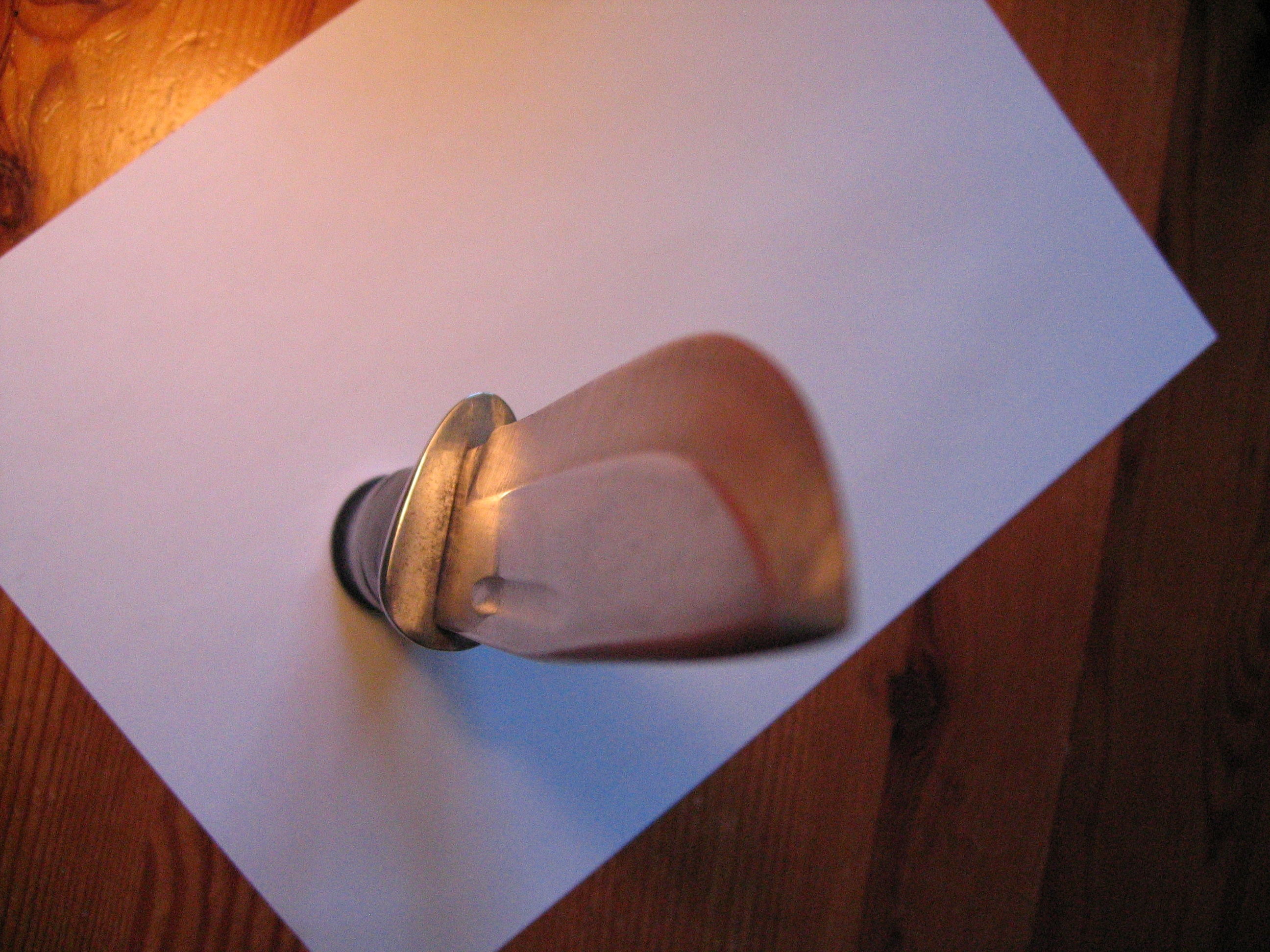

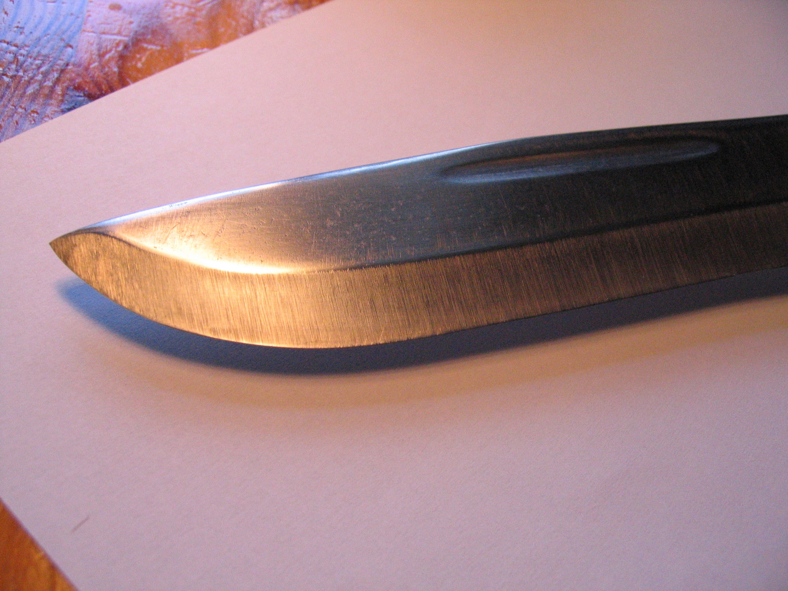

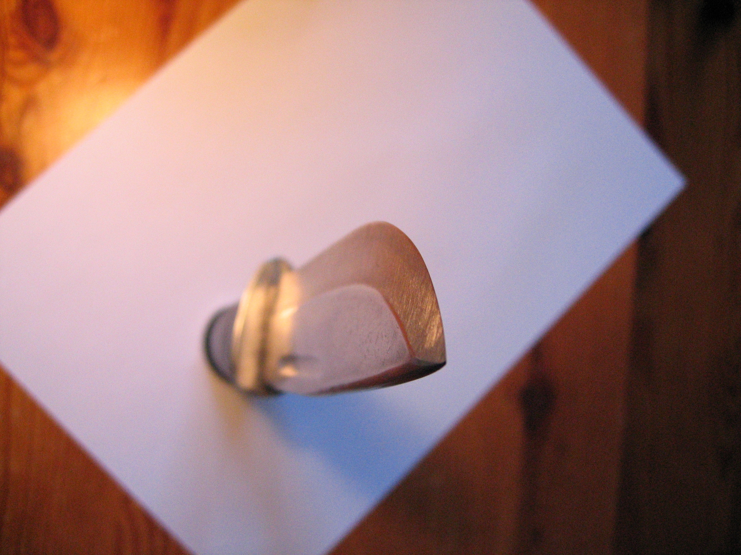

This is my Cattaraugus 225 Quartermaster which i got for free when i bought another knife.
This one was missing a piece from it's tip, had no edge to speak of, and the handle also looked like somebody had tried to saw it in half.
So i made it into a little project.
The leather handle is now coated with a few thin layers of Snoseal and the hammerhead was sanded and polished.

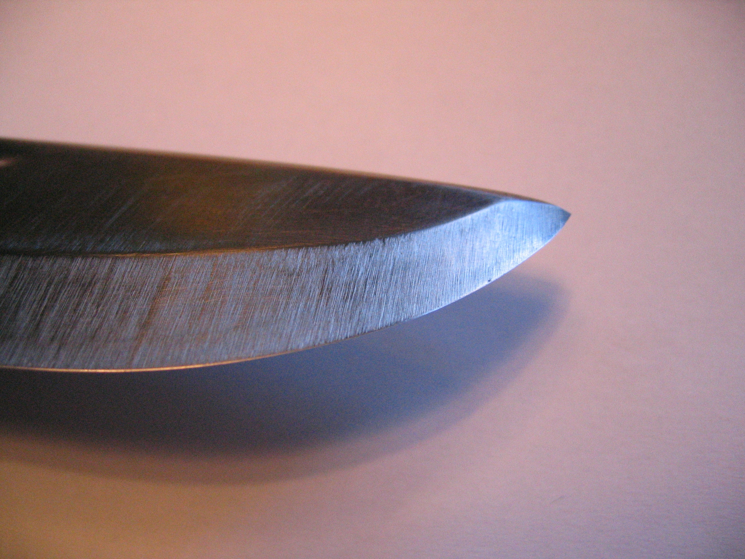

The sabergrind blade was transformed into a hollow grind using a Tormek machine, while the edge itself now has a microbevel of 40 degrees.
It will treetop hair without any problems.
I'm not sure though if i'm going to make a swedge on it or turn it into a nice drop-point.
cool mods on your knife! The "looks someone tried sawing it in half" could that have been the rough marks that are on all 225Q? It was a manufacturing flaw, when the knife was having the pommel added... on all unless it was fixed/rehandled later...
