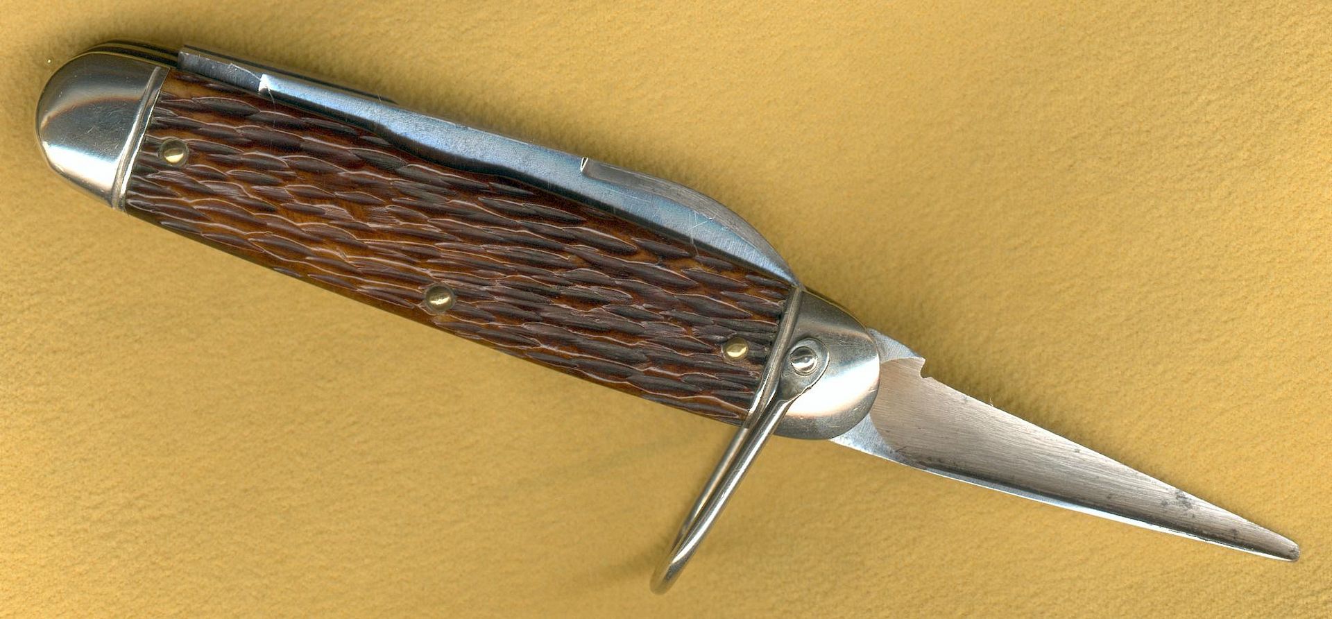

Showing a cattle knife, 3 5/8". Old jigged bone. Propellor shield? Extra long pulls. Marked Wester Bros / Warranted / New York
Anyone have a similar knife? Comments on the manufacturer, or the vintage please. Thanks.

The bone looks like product from the Walden Cutlery Handle & Manufacturing. The punch looks like Schrade.

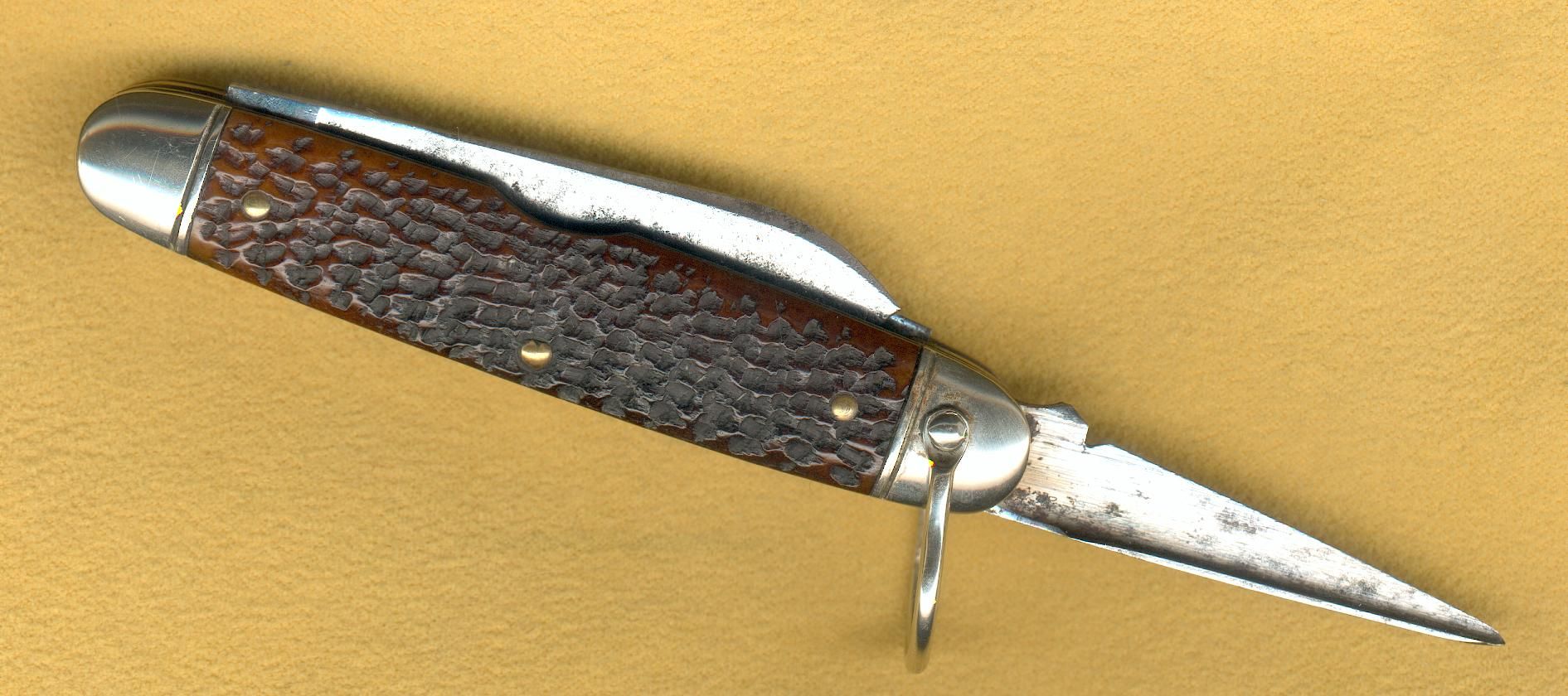

Both of my knives are Schrade Cut. Co.
The Girl Scout (lower) punch was made thinner, so less "hollow", to proportion it to a smaller, slimmer knife.

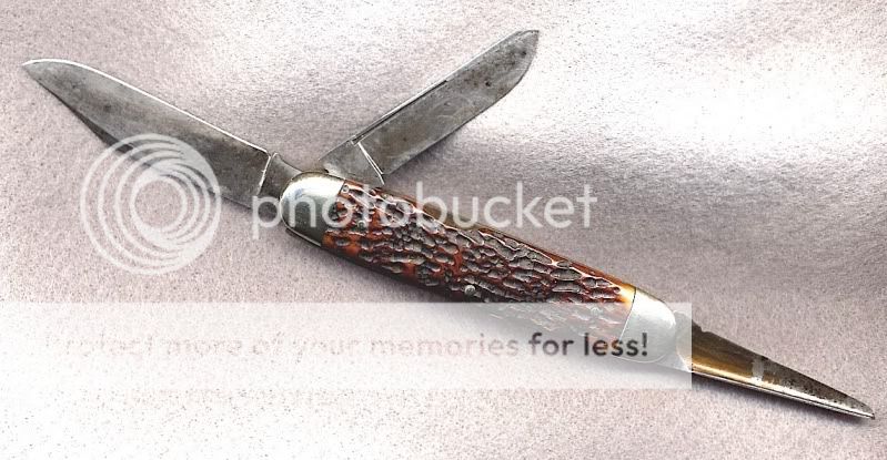

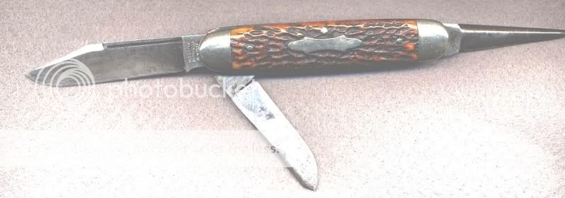

Not the same pattern, but the same stamp: WESTER BROS WARRANTED NEW YORK Thought to be from the 1915 period of no German imports. This knife is exactly similar to a Schrade Cut Co of the same pattern (pin position, shield, size). Barry
Pg. 385 right column fourth knife down Antique Knives 2nd edition by
J. Bruce Voyles. Same knife with spear blade #s8373. This knife with clip master would be s8373 3/4. Schrade Cut. Co.
Banner shield. The knife that Barry posted has a propeller shield.
