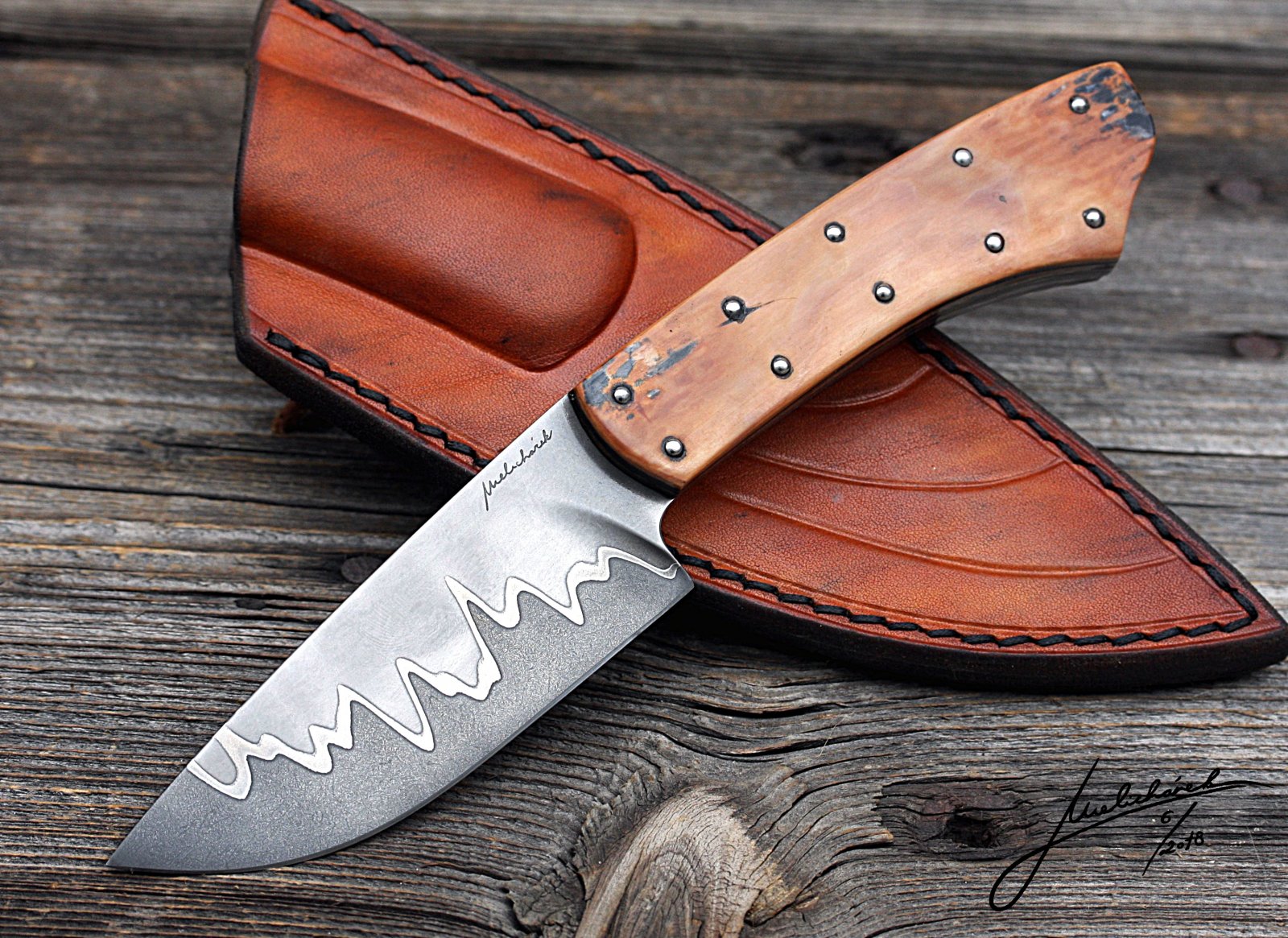

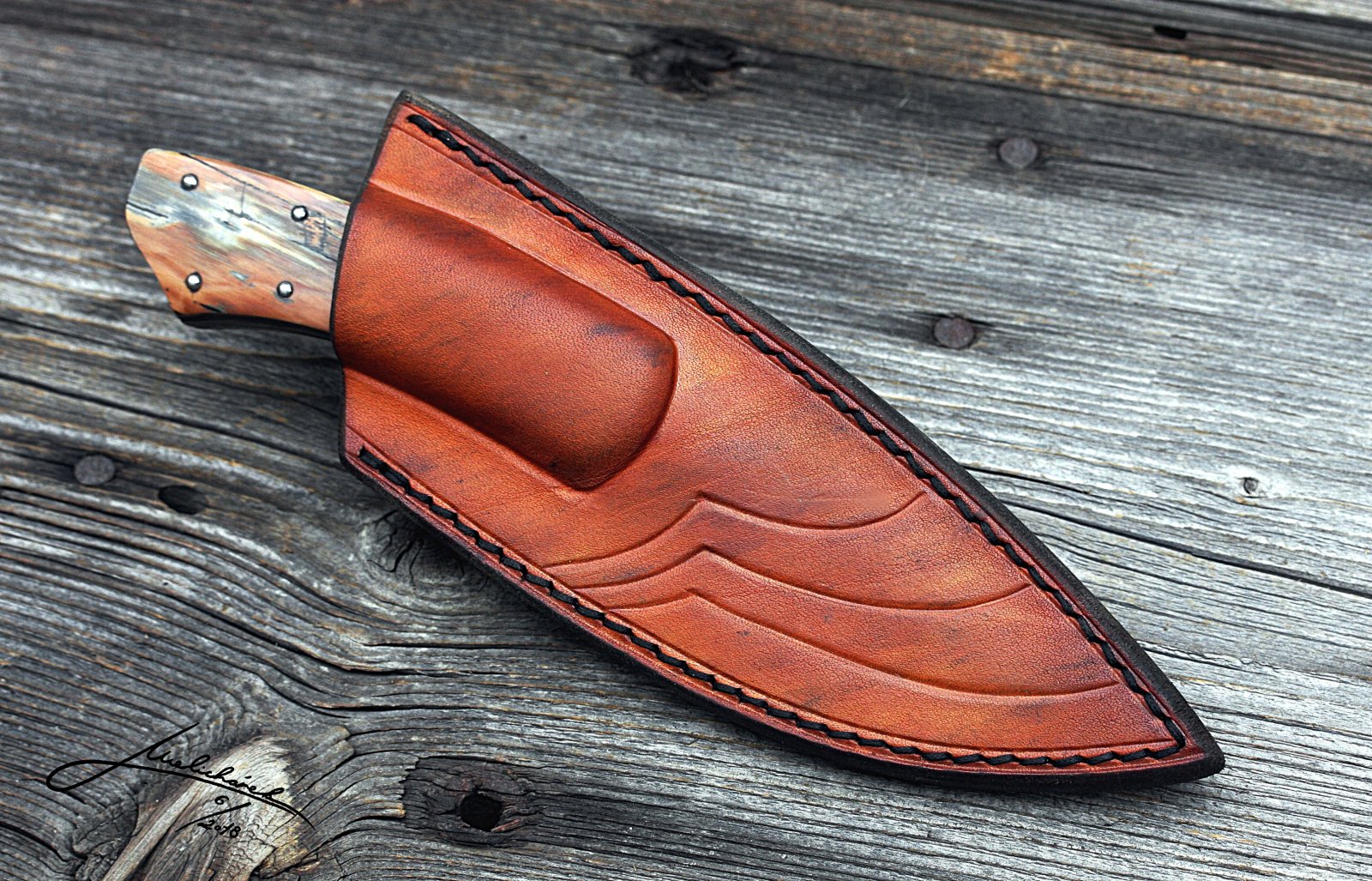

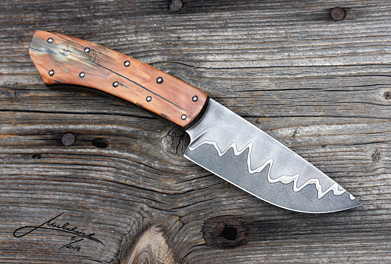

Hi everyone
I just finished this knife for my friend . He always wanted something with mammoth ivory so i hope he will like it
Until next time .. bb Petr
Cavis

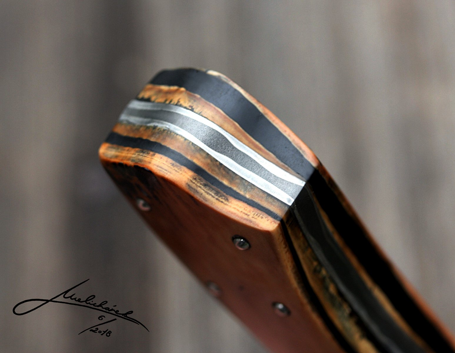

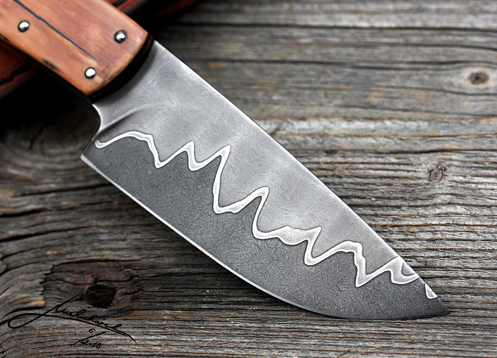

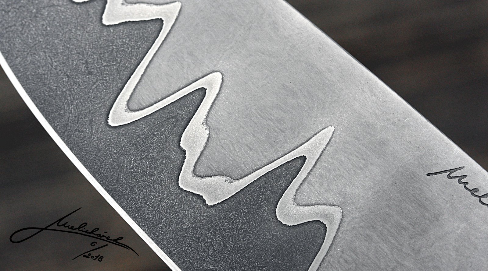

Blade - Corrosion resistant laminated steel- core 1,2379 (D2) + sides 1,2083 + 1,4301
Handle - fossil mammoth ivory - stabilised . Domed stainless pins.
Average length - 21,2 cm (approx- 8,35 inches) , blade - 10,3 cm (approx- 4,05 inches).
Blade width at widest point 36 mm (approx 1,42 inches ) mm , blade thickness 4,1 mm (0,161 inches).
