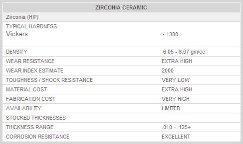

Almost all ceramic knives are made of zirconia (zirconium oxide), which has a Vickers Hardness (VH) of about 1300. That's not as hard as other abrasives, let alone cubic boron nitride (CBN).

Wait, so AlOx is harder? Looks like I gotta test this. I doubt it would abrade much, but not having to get special belts to do ceramic would be nifty.
The chart is approximate, because there are slightly different forms of each ceramic. For example, the zirconia in ceramic knives is not pure zirconia; it is often "transformation toughened" zirconia with other elements added in (such as yttrium) not to mention some fancy chemistry and stuff for the transformation toughening. Plus stuff like microstructure (size of crystals in polycrystaline versions), and allotropes/polymorphism matter.

btw, personally, I found ceramic knives really super hard to grind properly. I think that probably aluminium oxide, silicon carbide, are probably not hard enough to be useful in practice (will scratch the ceramic, but they are too darn slow!). I think I would recommend CBN and diamond, although I haven't had much experience sharpening ceramic knives.

I tested it, and AlOx can, in fact, abrade ceramic. It is terribly slow going, but it did give me a *slightly* sharper edge. I would never use it to take out chips, but it will do something if you have nothing else.
