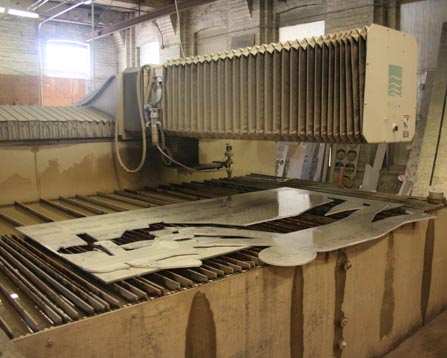

Water Jet = cutting the blank shape of the knife out of a piece of bar or plate stock using abrasive water jet cutters. This is a 2 or 3 axis cnc process that uses emory powder (abrasive) and water shot through a very small orifice at high pressure. Abrasive water cutters are more efficient than straight water cutters. The process is also used in the food industry with water or oil to cut things like bread.

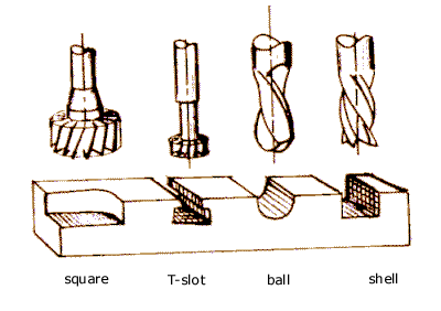

cnc milling = using a 3, 4, 5 or 6 axis mill to remove metal using a cutting tool such as a ball end mill. This is whats done to create the bevels on the knives. Normally you might use a fly cutter or an shell end mill to create a flat surface, if you use a ball end mill you get a series of grooves. 'cbt' is a milling process.
