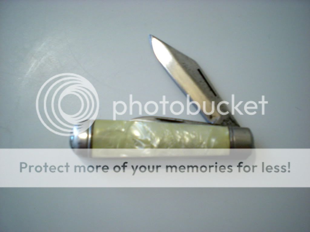

I just got an older Imperial folder with Cracked Ice scales. These scales are beautiful, my camera sucks. I've heard that you need to be careful with them. What are the do's and dont's with this material?
I'll let the real experts answer your question more fully but one thing is to avoid storing the knife near your other carbon steel knives.
If (when) it degasses it causes a nasty oxidation and you don't want it to spread to your other knives.
I'm sure Dwight, Charlie and some of the other more experienced vintage collectors can chime in with more hints regarding storage and maintenance.
A nice dark pocket is a good place for it. The worst deterioration I've seen has been in display cases subject to lots of light, especially sunlight!
I keep my valuable ones in the dark, but well ventilated. I had one go off in a small box, and the intensity of the fumes in that tight space ate the knife pretty badly!!
If you are lucky, yours will have been manufactured in optimum conditions, and will last.
No one has been able to predict with any precision if or when some celluloid will deteriorate. A proverbial crapshoot; but sometimes a beautiful one!!
