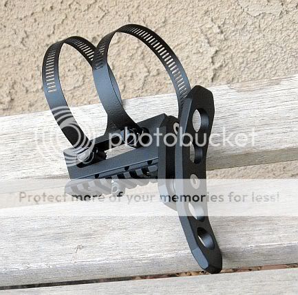

Connect the part to the machine and spray the powder through the gun, as it gets an electrical charge which is then attracted to the charged metal the powder particles stick to the part. Once the part is covered completely you then bake in the oven. It will turn shiny and glossy as the powder melts and then it will begin to cure and harden. Once it is done baking and then cools the part is read to use.
It is tough as nails. I use it on stuff like this. I have used it on tactical knives and it looks just great. Then enemy is sharp corners that is where it will chip. Once the part is cured you literally have to take it to a belt 120 grit to get it off.
