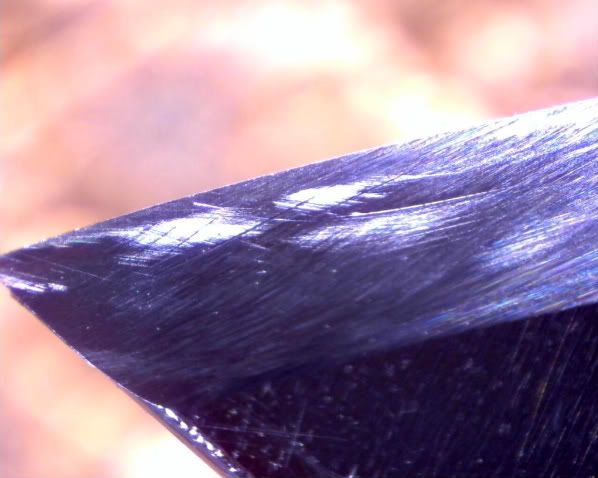

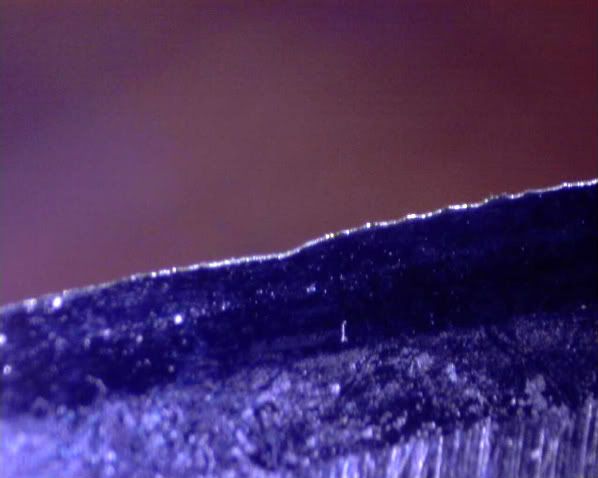

Today is my day off and I was a little board so I decided to put a fresh edge on my 52100 mule team. It didn't really need it but I haven't used my spyderco ceramics in a while and I wanted to put a nice mirror polish on the edge. I started with the medium stone and after a few minutes was ready to move on to the fine, I started working on the fine stone and the bevel was getting a very nice polish but the edge was feeling very ruff and had a real nasty burr. I used a few very lite strokes to try and remove it but couldn't get it to go away, I decided to move on to my UF stone to finish cleaning it up but after a few minutes of that I was getting nowhere. I thought I was using too much pressure or maybe I didn't get to the edge with the brown stones so I started over using extra lite pressure but still got the same results.
This is the second time I have had this issue with a carbon steel blade but this time I got pic's. When I took the pic's I could not believe what I was seeing, I know I have sharpened this knife with the ceramics before and didn't have a single problem but now my edge is chipped.
I'm really lost as to what is happening I've tried everything but I still get this. Any thoughts?
Near the middle

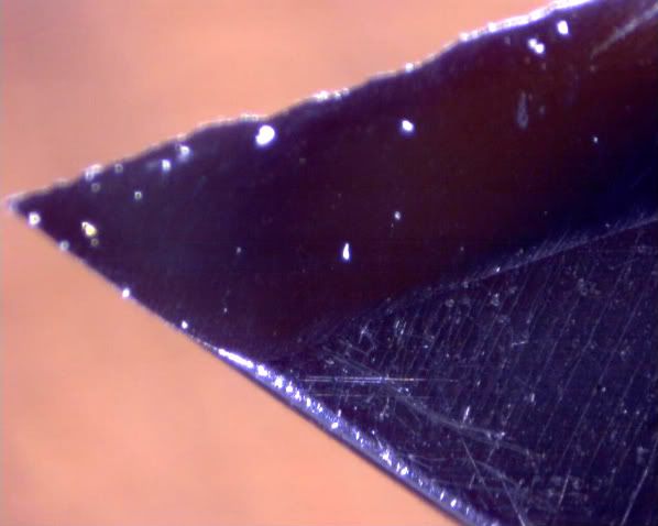

Edge re-sharpened with DMT hones to 3 micron.

Some things I did notice though is that it only happens with carbon steel blades and the chipping only occures on the fine stone.
I have had the exact same problem with all hard M2 (65-66 RC) and Super Blue (64 RC), and have seen it to a lesser extent with ZDP 189 on my ceramics (benchstones). It was micro chipping just like that on the first two steels, and generally when I have issues with ZDP-189 (sometimes I have no problems, probably when I use less pressure) it is a micro burr that limits the sharpness I can get even after using lapping films or strops, as I have found the cleaner the edge I have prior to stropping the better the finished product. I just moved to using waterstones a couple years ago when these issues popped up for my ultra hard steels, though I must say even M4 and the 52100 Mule sharpen fine for me on the ceramic. Maybe your Mule is on the hard side? Every other steel I have found the ceramics great on. From VG-10, S30V, CPM D2, D2, to most any other steel I can think of I have had great success with the ceramics. I am glad you caught a great picture of the edge, as that is exactly what I saw under my 100x microscope on all hard M2 and Super Blue, but I could only use my words to describe the micro chipping, where that picture says it all so clearly. Again, I am a big fan of my ceramics, but I just decided to stick with waterstones on my ultra hard steels. Sal could probably use the perfect touch to get a perfect edge with the ceramics on the knives I have had troubles with, but for me and my ham fists the waterstones and their forgiving (but messy and high maintenance) nature are what I need for those high RC knives.

A burr? No, those are chips. I would be much happier if it was a burr though.
It could be that your ceramic sharpener is too hard and chips the edge upon pressure, whereas your diamond stone is supported on medium-soft nickel. Maybe try Japanese waterstones? They are soft. In any case the edge is brittle. If you re-heat treat it to the same hardness and don't get any more chipping, then there's our answer.

I get the same thing happening with ceramic rods, up close (jewelers loupe) views you can see wavy patterns like the pics above. I have experienced this with 154Cm, S30V and D2. When i use a FLAT ceramic stone i do NOT get these wavy edges or chips, only with the round rods.
Well, my experience is very close to that of OP.
Using my (Spyderco) ceramic benchstones on harder steels (60+ HRC) results in this very dull, chipped-like edge. :(
But I still do think it is because of ripping off (instead cutting off) the wire edge, mainly because ceramics cut very slowly and unevenly.
