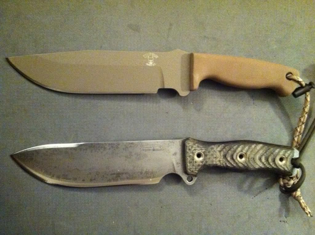

Anyone care to explain the difference between the two, I tried searching but couldn't come up with much.

Combat Grade is just a grade of Busse's knife models marketed along a lower price point than the limited editions. CGs are the standard Busses, meant for hard use, hence the label of combat grade. Not "show" or "museum quality" I guess if you want to compare it to something.
Competition Finish means a blade is unfinished, done so they can keep costs low. They keep the decarb layer on rather than polishing or coating. There were lots of complaints about corrosion, and now they double cut it.
Competition Finish is no frills, no coating, usually convexed edge. The earlier ones weren't finished at all above the edge, but the newer ones are blasted to remove the decarb layer.
CG are coated, unfinished under the coating, and could have any kind of edge grind depending on the model.

the CF BWM are the newer style with the decarb blasted off. I think it is actually a single medium blast, unlike doublecut that uses 2 different blasting media. That is why the finish is so consistent compared to the 2008 SE old style CF stuff, but not as fine as doublecut
It should be double cut. I don't know about all Competition Finished knives, but the CF BWMs are.
The "Competition Finish" is a bit different than the previous Competition Grade in so far as we are double cutting these prior to sharpening! This will cut down greatly on the decarb/oxidation issue.

The newer version of CF has the decarb layer removed to aid in rust resistance. A true double cut blade has all the dimples removed and the steel is the cleaned up a bit. Not exactly a satin finish underneith as we do not remove all the minor scratches prior to double cutting. A CF is simply steel with the decarb layer removed with no additional cleanup.
Hope that helps.
