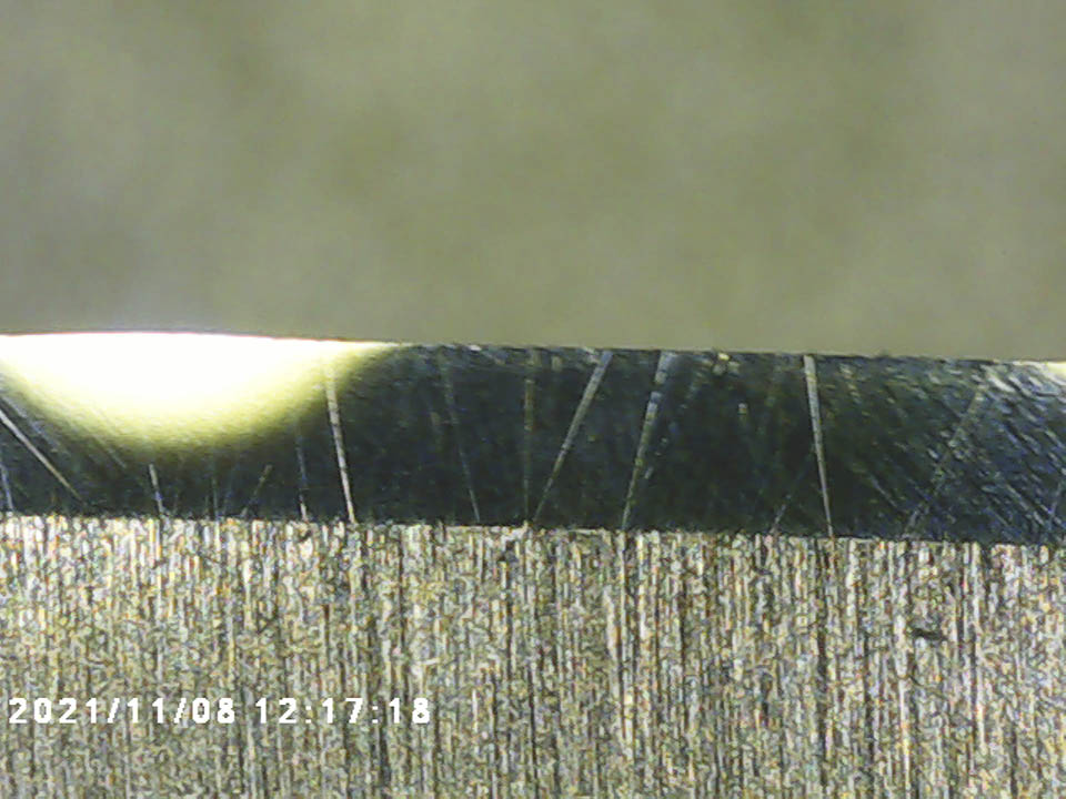

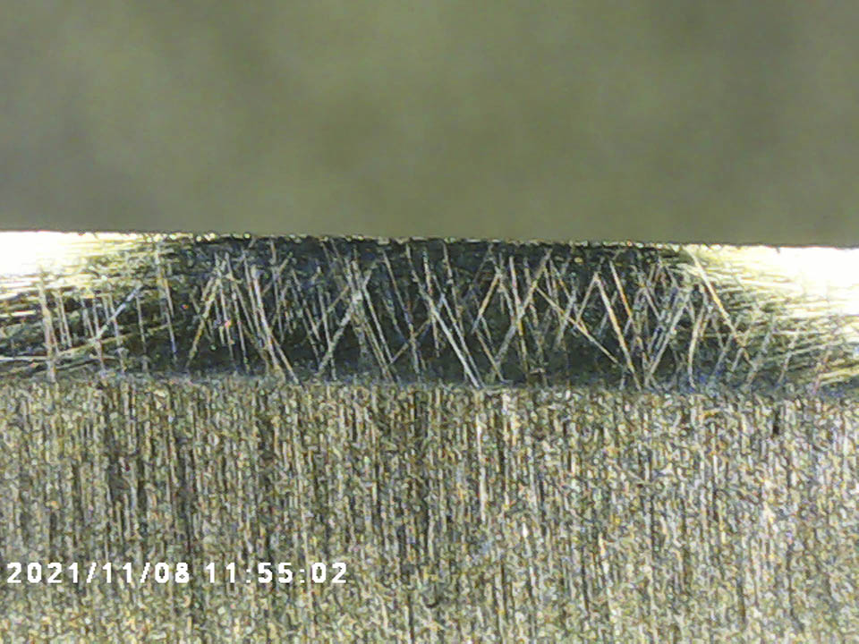

If you go through all of the stones you end up with a near-mirror finish -- very nice indeed. In fact, I found that the appearance of my edge was getting worse when I followed the 5 micron stone with KME's 3 micron lapping film! At first, I thought it was my imagination, as the lapping film ... even a 6 micron film, let alone 3 micron, should produce a better result than a 5 micron diamond stone. So I finally whipped out my handy-dandy USB microscope, and this is what I found:
Above is the bevel after the CGSW 5 micron stone.
Above is the bevel after the KME 3 micron lapping film.
Say what? Clearly the CGSW abrasive is more uniform than KME's lapping film. What's more, I found the same result with the KME 1 micron lapping film! In contrast, I found that the KME kangaroo strops with .5 and .1 micron CBN emulsions worked great and produced a true mirror finish. In the future I will drop the lapping films and go exclusively with the kangaroo strops and emulsions.

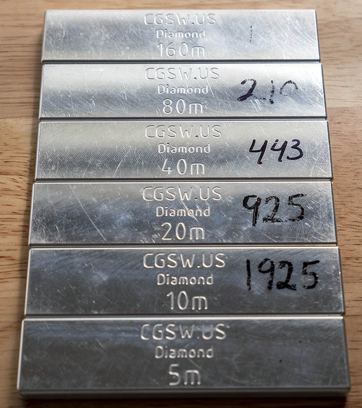

In your second photo third stone up from the bottom it "looks like" it didn't get completely dressed. It looks like the perimeter is dressed but the center still has the as-molded surface.
In your first microscope image, those stray scratches are most likely from edge leading passes catching the burr, pulling it between the stone and bevel, and scratching the bevel in the process. Often I have seen these scratches point to a microchip in the apex. That chip or burr can become embedded in the stone requiring a dressing to remove it. The finer the stone the more of an issue this is, being most prominent with the 10 and 5-micron stones. If you stick to edge trailing passes only those stray scratches should disappear, if they bother you.
