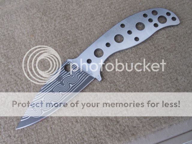

Im not chainging the hole pattern on my Mule per se.
I do how ever plan to widen two of the holes slightly to accomodate titanium chain ring bolts.

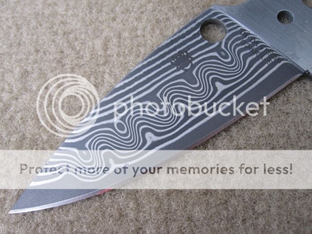

Here is my titanium Mission MPU with homemade carbon fiber handle (I havent gotten around to the Mule yet, but after drilling the titanium, the Mule will pose no problems).
Two holes were drilled slightly bigger, as the titanium chain ring bolts dont fit the standard holes.
The Suminagashi Mule is next (unless I change my mind;))

If that was meant for me, it should pose no problem what to ever to slightly widen two of the holes in the Suminagashi mule.
We are talking less than a millimeter.

If you want to custom-fit some bolts, I would recommend using a carbide reamer to enlarge the existing holes - although this could be tough sledding on some Mules...

Dont remind me:D
Just drilled my BETA ti MPU to enlarge the handle holes and you could virtually hear the drill groan:o
Managed to fit chain ring bolts with not much drama though.
