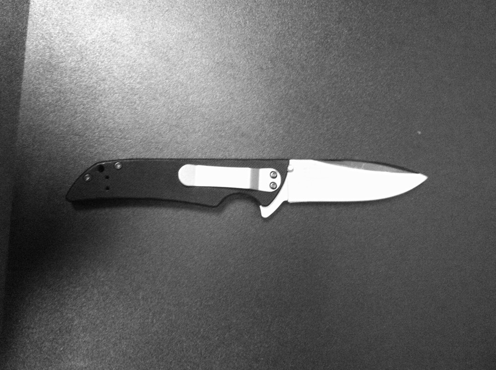

This is a Kershaw Skyline. I want to change the design of the bladeshape by getting rid of the "black area" on the blade. (This is the steel that is visible while the knife is closed by the way)
I was just wondering what the best way about doing this at home would be? I've never done this before...

That steel is removed very easily.
A bench grinder is fine, just be carefull!
Use a sharpie to draw the shape you want and start at the part that has the most mat'l to remove so you can see how fast it comes off.
Leave yourself a little bit of stock and finish by hand working with diamond stones.

Thanks guys, I'll see what I can do... I might do this at my brothers as he has a much better shop than mine. I'm kind of worried how I can do this safely without a blade flying up and hitting me in the face.
I plan to cut it, polish the edges, and then probably paint it black. I might try to add jimping on the top too... kind of like a 0780.

I've ground down a few blades with a bench grinder. The only tips I can give you are either use the tool rests with a very firm hold or take the guards off and use the wheel at about the 7-8 o'clock position (which I prefer) I've never hade a blade shoot off the grinding wheel either even with a fairly loose hold. You could even dull the edge and tape up the blade for added safety.
A little primitive, but couldn't you use a file?
It might take a bit of patience, but you don't run the risk of ruining the heat treat.
Taping the blade might still be a good idea, at least the edge.
