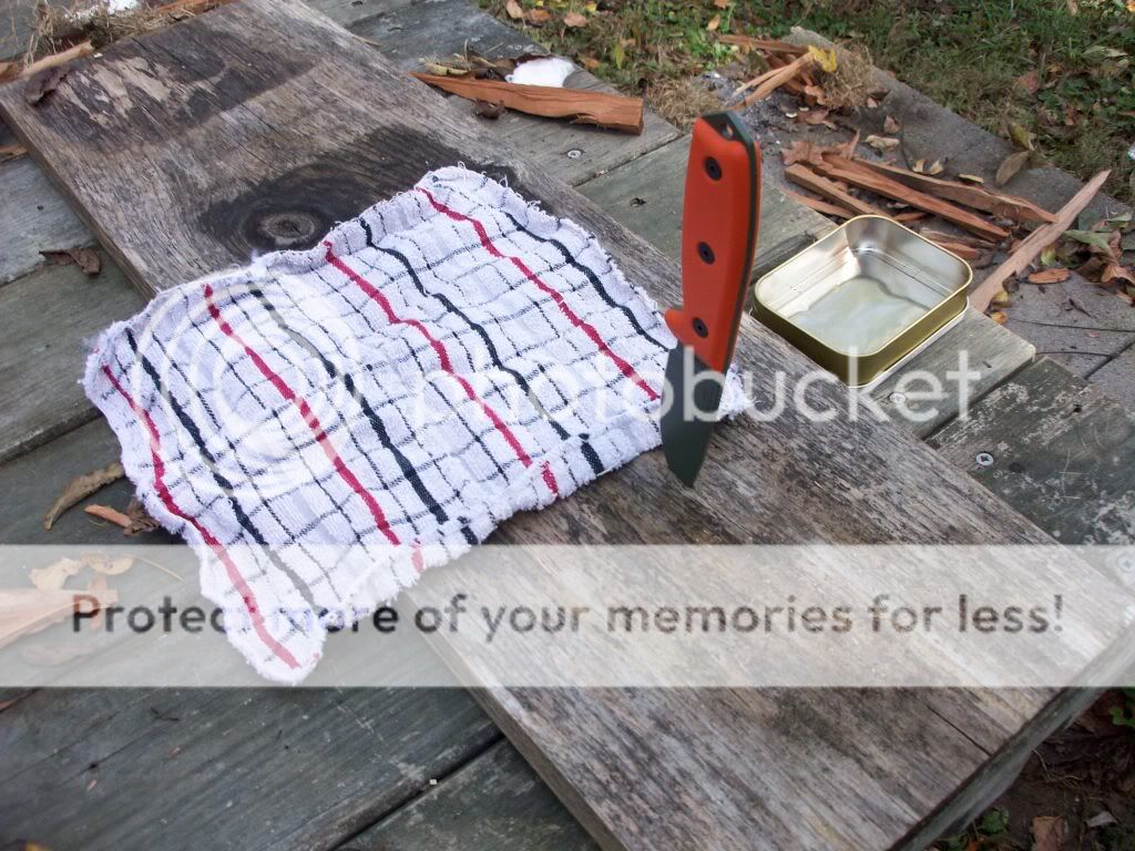

List of stuff- ESEE3, ESEE Fire kit(stocked with fatwood shavings), a tin (thanks Slugman, you gots the tins for sure) and an old dishrag

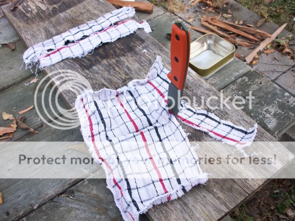

I tabletoped the rag into strips using a pull through

Strips into patches, ESEE3 to the rescue

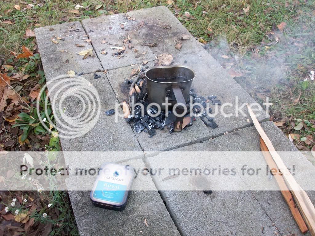

Time for the FIRE, we always talk about getting the "spark", but preparation is the key to a successful fire. Sorry, I know we all know that, but I thought this would make a good pic.

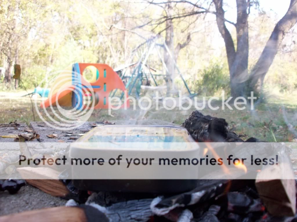

Tin stocked with terry cloth rag patches, hole punched, and coals ready. Lets char some cloth.
Smoke is boiling out of the hole, I go until I get a little jet of flame out of it. Note: When you pack your tin, make sure there is no cloth near the hole or it will clog up

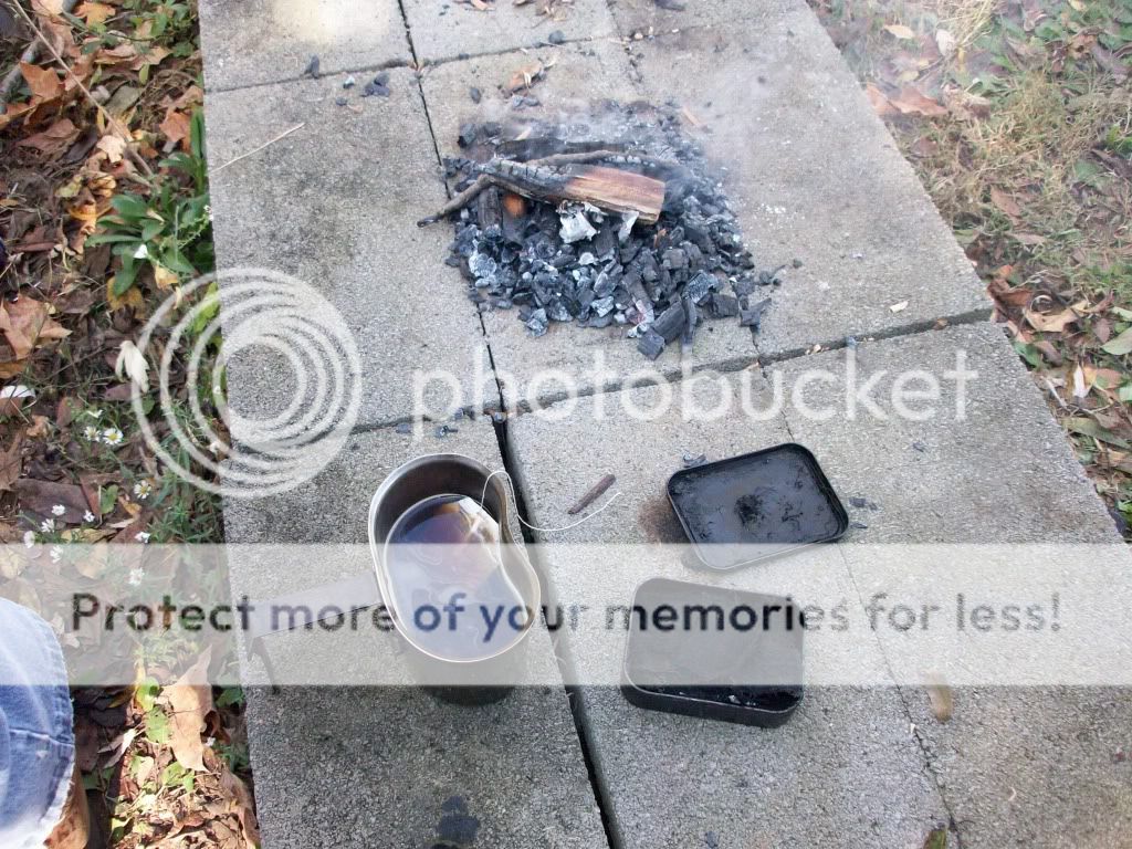

I got my little jet of flame, still got some good coals, better brew some tea while I wait for my tin to cool to the touch.
All done. The tea was good, a little lemon and sugar. Charcloth turned out well, it took a spark right away. What you don't see is Lady glaring at me with her work gloves on, a CS Kukri 'chete in hand, standing by the burn pile. I just sat back and enjoyed a beautiful late morning in the fall, cool air, beautiful lady, warm tea, and a successful mission. Thanks to all. Moose

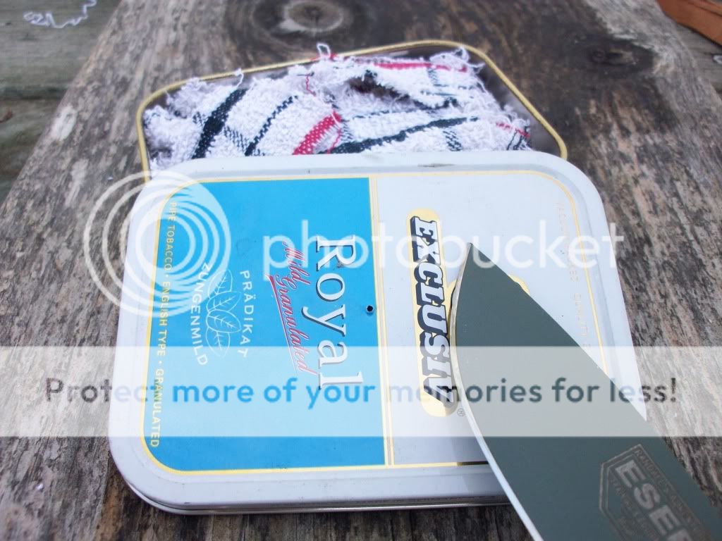

This was a new tin, and I needed a pinhole in the top, ESEE3 again, with its needle point tip, perfect 1/8"hole.
