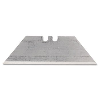

While sweeping out the garage I found a utility knife blade on the ground, all rusty. Don't know why, but I always thought they were stainless. I must have been thinking of safety razors, I'm pretty certain they're stainless. The snap-off type utility blades are often listed as stainless. A few tests should let me identify the steel, but I think they will work. They're big enough to etch and they're already heat treated.
