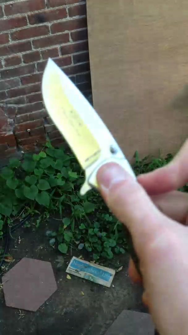

- Smooth flipper action. With just a drop of nanolube, it is as smooth as one could hope for with nylon washers. No adjustment or wrist flick necessary. (Short, terrible-quality video here)

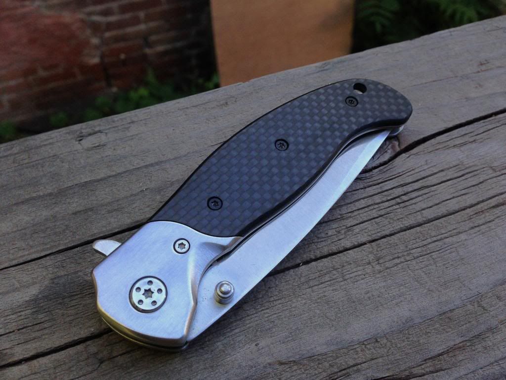

- Attractive design: The bolsters look great, and the Carbon Fiber (while a bit dull) looks very good.

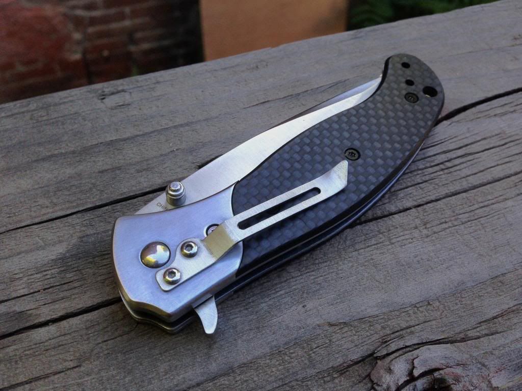

- Repositionable pocket clip. Right side only, but, hey, at least there's an option.
- Good fit and finish: Everything lines up, there aren't any sharp unfinished edges, and the blade is centered.

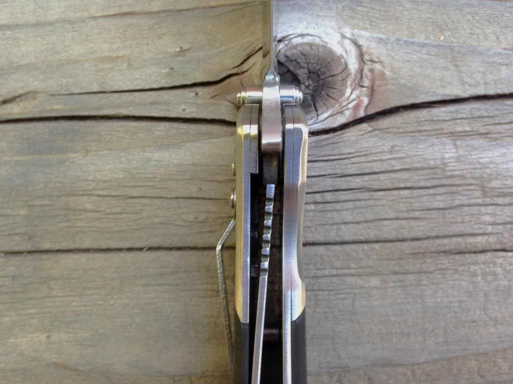

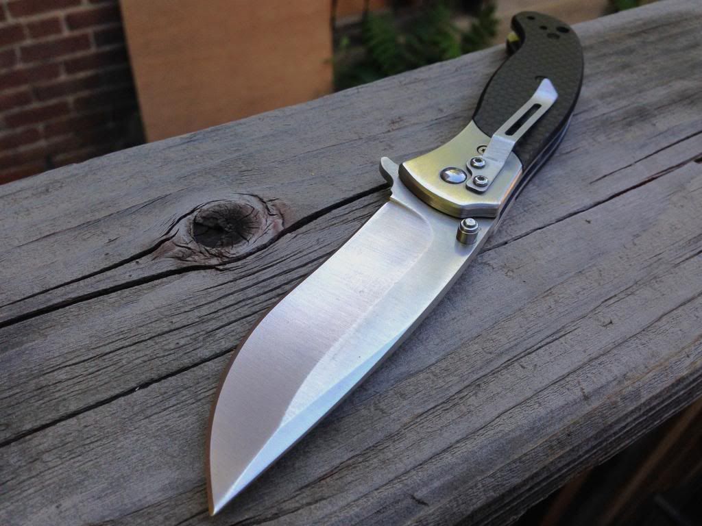

- The tip is very poorly ground. It's hard to show it in pictures, but it's practically rounded.
- Lockup is relatively late out of the box. Solid, yes, but it locks up at ~70% already.

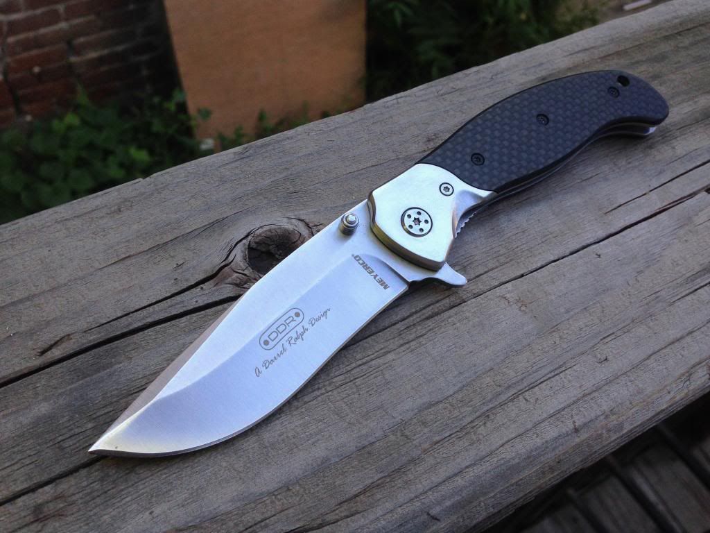

- Too much writing on the blade. This is minor and nitpick, but I hate having an otherwise handsome knife covered in logos and serial numbers. Leave it on the warranty card or make it discrete.
You'll notice the negative marks aren't exactly damning. It's still a handsome, fully-functional knife with a perfectly acceptable steel (8Cr13MoV). The recurve is not excessive by any means, and the blade was razor sharp after a couple passes per side on a strop. The hollow grind is very high, the edge is evenly-ground and looks to be close to 15-20 degrees.
