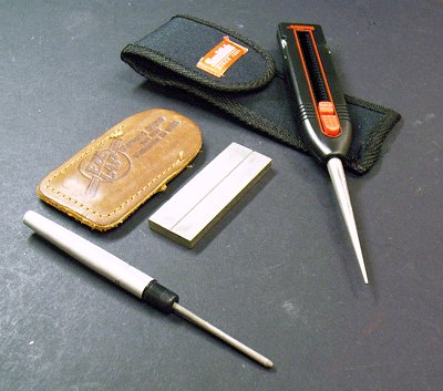

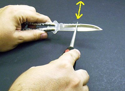

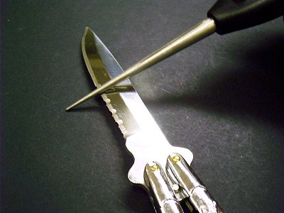

To sharpen a serrated blade, you'll want to get a tapered rod sharpener, or a triangular sharpening stick. There are many available on the market. You use the edge of the triangular stick or the tapered portion of the sharpening rod to hone the individual serrations, drawing the rod down through the "valleys" of the serrations at the appropriate angle.
I have a Smith's retractable diamond rod hone that has served me well for many years.
