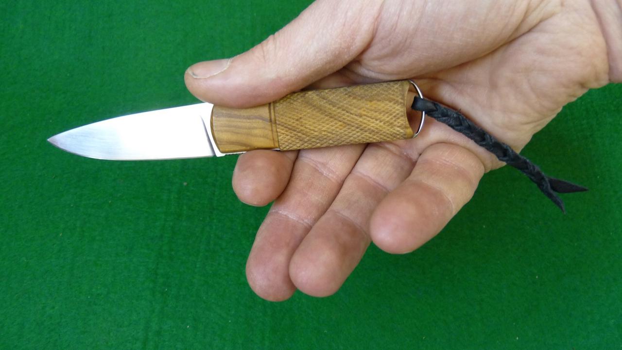

This is a self made EDC.
Tight curves with a border tool will be hard, those tools are made for gun stocks wich are a lot larger.
Ajust your design to the tools you have and what they'll do.
Take your time, zoom out of this world and in to that small piece of wood infront of you and don't be distracted.
Have more light!
I have a 3 line cutter, that helps a lot. Let it ride in two lines, cutting only one.
Don't cut your lines to deep, you'll do that with the 90degree cutter. And don't be tempted to already do some lines with the 90degree before all 60degree lines are cut.
Take your time checkering isn't something to rush. It's pretty unforgiving, no way to hide mistakes.
I enjoy the process and yes it gives a nice grippy handle.
The next knife I'll start will actualy have a checkered handle.
