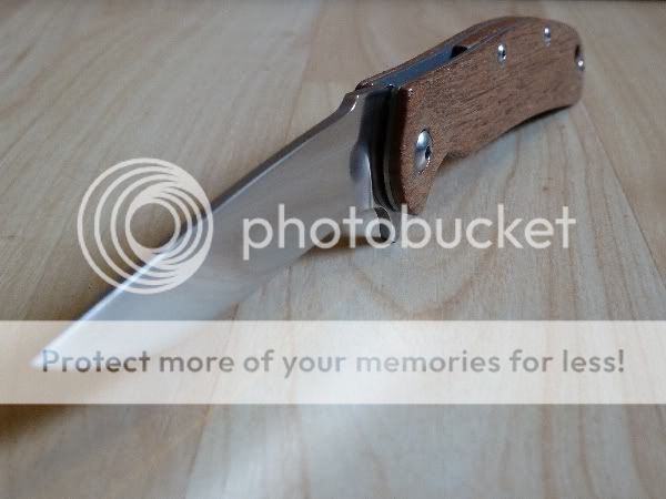

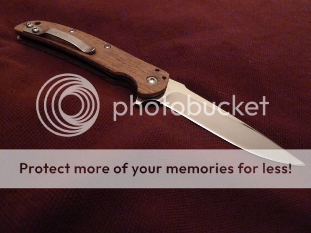

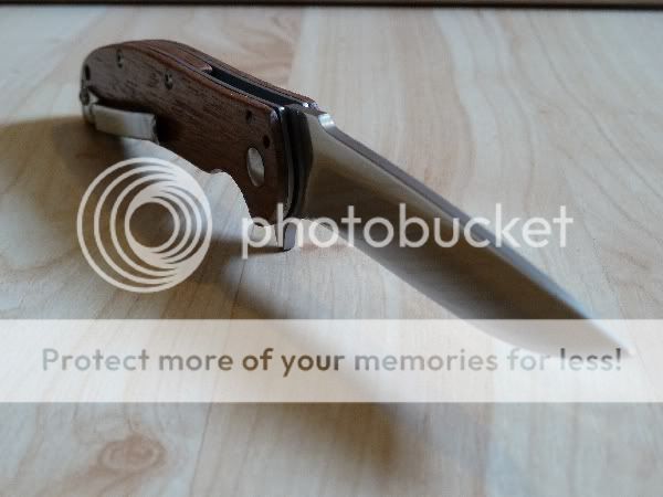

I wanted to make my Chill a bit more stylish and unique. Quite satisfied for now with the mods I made to it. It's not finished and not perfect yet, but I'm happy to share the progress. Hope to finish it this weekend, so then I'll update it here again (with some better pictures as well).
Here she is.

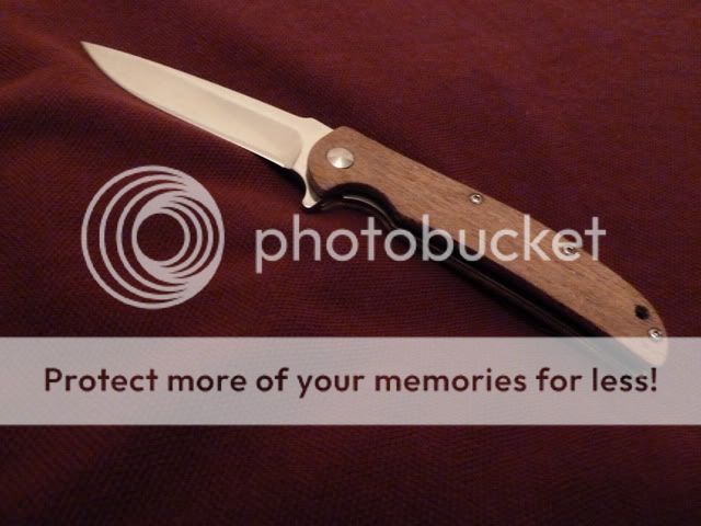

I made some scales from some ipe flooring scraps and made a black Micarta spacer for it. The ipe polished up really nice.
I got another chill to mod. I think I'll use some osage orange or maple for the scales and possible take off the thumb ramp like Iman30 did.

Update:
Finished it 2 weeks ago, but didn't have time to make pictures and upload it.
Thanks for the commands btw!

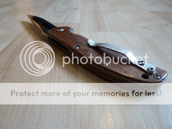

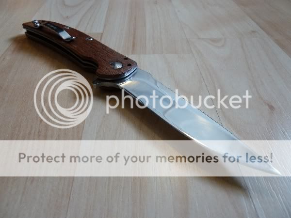

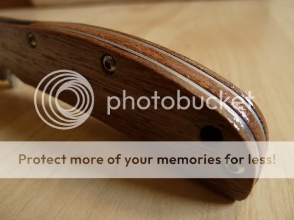

Modifications made to the original Chill:
-Removed secondary bevel 2 convex
-Polished blade to near mirror polish (didn't want a full mirror polish since you see much easier when it's dirty)
-Polished the pocked clip
-Replaced black G10 scales with hardwood scales (polished and finished with varnish)
-Replaced black "spacer" in between the scales also with hardwood (polished and finished with varnish)
Notes:
-Noticed the hardwood I used was not ideal since it splits quite easily (not sure which one, but I guess it's merbau or meranti).
-Next time I want a finer wood structure as well (so I'm able to get a better polish).
-Accidentally added screw holes for tip down carry as well, but I only use tip up :o (next time I'll leave them out and the lanyard hole too)
-Didn't modify the thumb ramp yet, not sure if I want to remove it or add some jimping.
-Sometimes I miss a thumb stud to it for ease of opening. Now and then when I deploy with the flipper it doesn't open entirely, having a thumb stud would make this easier.
-Oh and it cuts like crazy :D
-@lman30 some high end blade steel would be cool!
Some more pictures:
For those who made modifications to their chill as well, I'm curious about some pics. So add them to this topic :thumbup:
