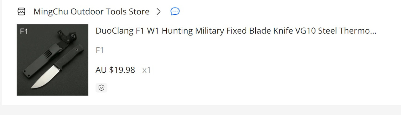

Review Chinese F1 fixed blade
old4570
Banned By Request
Jul 28, 2010
803
HRC File test = 45/40 ( 45 bites / 40 skates ) That's some soft steel ..
Knife burrs like an olympic champion .. ( That soft steel )
Knife is comfortable , easy to use .. Sheath is ..... functional cheap plastic !
Factory edge was .................. non existent ! ( Had to grind my own - pretty much )
Factory bevel was 18 degrees and with such soft steel , I'm not sure that is going to work out so well .
Video soon :
Now I did not test HRC before slicing rope ..
So the soft steel kind of explains what is going on ..
Now , I used my guided knife sharpener to resharpen the knife and clean up the bur . ( Took a lot of work )
So I will slice again , unfortunately I left the bevel at 18 degrees .. So the edge may roll @ 200 or so again .
What a piece of crap. Not Fallkniven. Not even VG10.

Not worth posting video for this :
I cut rope with the guided knife sharpener edge .. @ 18 degrees
The edge folded like an Olympic champion @ 100 slices ..
4 strops of leather and it was cutting ( 2 each way ) ..
I was going to do a 60 grit 22 degree edge ... Butt!
I was doing a few knifes for 80 grit testing and so the Chinese F1 got a 22 degree 80 grit edge .
Ok so this is the last one ( I think ) for now ( test )
Edge was reground @ 22 degrees and given a 80 grit grind .
Previously it rolled the edge at 18 degrees and 80 grit for a 200 fail
This time at 22 degrees it failed at 250 slices and did not roll the edge .
So a $25 knife that fails at 250 .. That would be 10 cents a slice knife .
The edge stropped back relatively easily , though not quite as well as at 18 degrees . ( But no edge roll )
Hate this knife / don't hate this knife / = Cheap price with average performance with a value index of 10 cents a slice .
