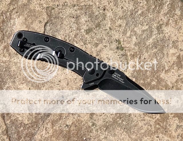

New EDC for me, the Kershaw Cryo-1555BW. I love the blackwash; the blade was centered and sharp. I do like flippers, and the speedsafe is OK. I looked at this year’s ago, and now after multiple purchases of Spidercos and Beckers it is my new EDC. I have knives with S30V, D2, AUS8 and 3cr18mov. I know there are a lot of different opinions about Chinese knives and Chinese steel. One question I have about the cryo, and some of you may be able to clear up. The blade is not printed 3cr18mov. It only says china. So is this still 3cr18mov?
My bad on transposing the numbers. All the blades I’d seen has that code on the blade this one only says China. I love this knife. I just wondered if it was still 8cr13mov.
Yep, the Cryo uses the 8Cr. There are much worse steels to be found on budget folders. 8Cr isn’t great by any means, but it’s not terrible.
