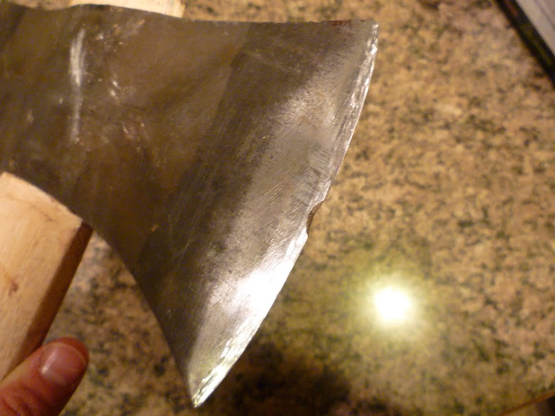

We went out and cut some Christmas trees today. In the process of cutting my tree, I somehow put this chip in the bit:
For scale:
When I saw the chip, it was pretty disappointing. I just hung this axe early this morning before taking off, and I have been super excited about this one.
So, where did I go wrong? It was about 25 degrees, and I didn't warm the bit before chopping. But I was casually chopping a maybe 3" diameter green tree. I'm shocked that it chipped. What are your thoughts? Who else has bad surprising big chips?

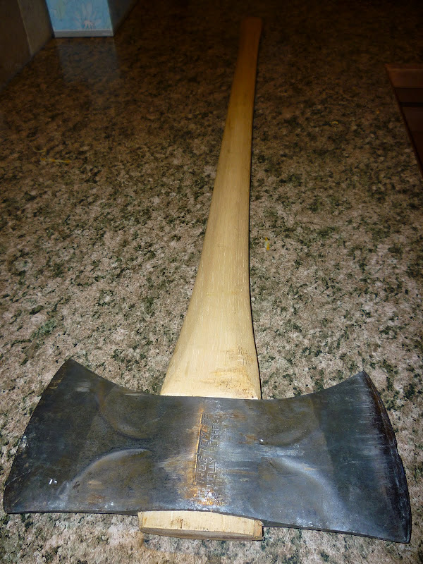

The axe is still bad *ss, no doubt. Needs more work now. I actually still need to clean things up a bit anyway and put an edge on the opposite bit. The handle I bought was super fat, so I spoke shaved it down to a nice thin, tapering kinda elliptical shaped octagon. I couldn't be happier with the way the handle felt in my hands.

Yeah that really sucks.
And I'm afraid to say, from those pictures, from the size and shape and the coarse grain appearance, it looks like an HT problem.

Considering cold is embritteling, it can't hurt.
Well I guess you know which edge to use for root chopping now! :o Since one edge is intended to be "sacrificial" for chopping near the ground, I'd sharpen that chip like a big serration.
I had never thought of doing that. I have an axe with a chipped bit and never sharpened it out cause I didnt want to lose that much edge.
What species of tree? Frozen conifer knots can wreak havoc on edges. Old timers around here never put a good axe to a frozen hemlock for example. That could have had something to do with it.
Like others have said though, I would just keep that edge for grubbing. Much more versatile that way IMO.

Yeah, I wonder. It's weird. We'll see how it holds up going forward.

The tree is a spruce. I did whack off a few limbs before chopping it down. Maybe it happened doing that, although the limbs were only like half inch in diameter. I guess it's the hardness the matters not necessarily the size, but I didn't even hit them hard at all because they were so small.

Unless you had the axe sitting outside all night, then went to use it, it should of been fine to use temperature wise. If you look at the old pics in catalogs about axe bit deformities, yours isnt from a bad head or metal, it looks like something that unfortunately happens in the axe world. There could be many reasons. Maybe it was the cold. Maybe it was the wood, knot, or sometimes trees do have weird stuff embedded in them. Maybe it was just good old bad luck. Maybe you had the bit sharpened too thin there. Lots of possibilities.
As stated many times, now you have your grub edge, and believe, every time you go to use that grub edge you will remember, and swing a little harder because your pissed. So be careful.

I just took a closer look at the chip. There were little chunks of wood stuck in there. In the pics it does look like some large grains in the steel. I think the grain under all the wood looked fine.

Edit: as far as the temperature of the steel. I'm sure it was air temp, which was about 25 degrees F. It had to be because it did not ride in the heated cab, and I had been hiking with it for awhile before I found the tree I wanted.

I was so proud of finding this axe as it is very full...or WAS very full. I'll post another pic up after reworking that bit in order to restore its dignity! :D
