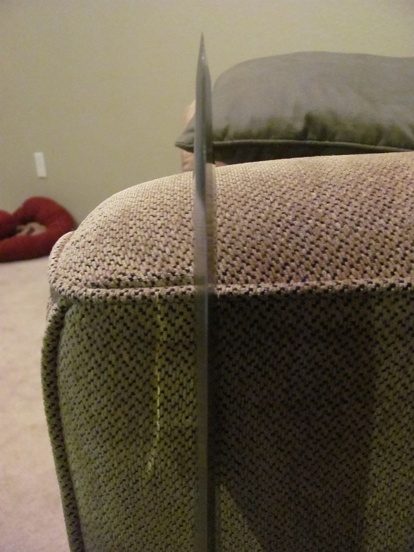

This is actually my first time using a khukri at all. Chopped through a tree branch about 6 inches thick and was very impressed by how easily it went. And absolutely amazed at it's edge retention. And then I drop it in my gravel yard because I forgot to button up the sheath it was in. It was one of the fund raiser sheaths. So after being very impressed by my first use of a khukri I went and messed it up, I dont think it's too bad, but I'm not too sure how I'll get the chips out. And I hope the chip isnt past the temper. One of them is right on the sweet spot. What do you guys think?

Could we please have an edge-on picture? Like, spine resting on the ground with edge in the air, point towards the lense so that the bevel could be seen? I wonder if you got one of the ones that's actually hollow ground, as some AKs have been in the last couple of years.
Those small chips should sharpen out easily enough. They happen if you hit rocks (even inadvertantly), Give it a try.
This is the best image I could get edge on. The blade has 3 surface angles. The 2 closest to the spine are both hollow, concave and polished shiny and smooth. The cutting edge is flat and looks like it was hit with a wire wheel or something. I dont suppose HI has a sharpening service?
