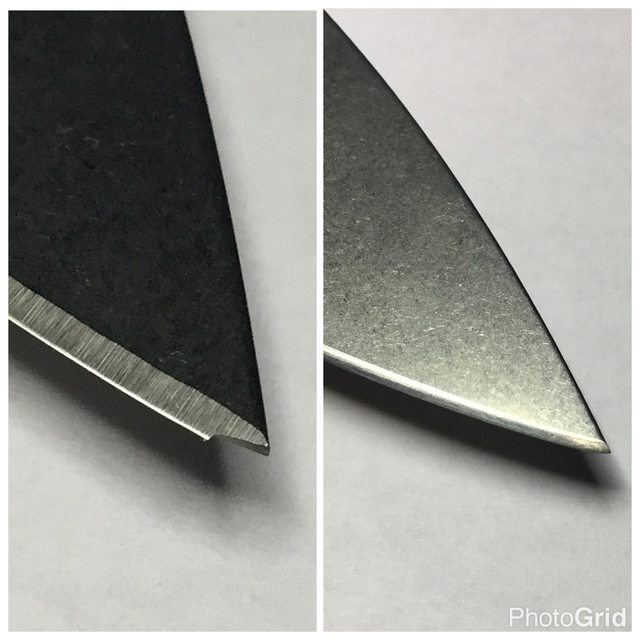

And I just got the thing! I'm a truck driver and I had to cut a piece of mudflap that was hanging off the side of a trailer. I'm guessing there was some sort of wire reinforcement inside the rubber. Anyway, it's chipped up pretty good. I've never progressed from my sharpmaker as far as sharpening. I have the diamond rods but I don't think that's going to cut it and I'm not feeling inclined to dish out the $$ for a better system.
Anyone know of a sharpening service that I could send this thing to?

How bad are the chips? I chipped and broke a tip off a S110v Manix 2 recently. I used an inexpensive DMT diafold with blue coarse and made quick work cleaning it up. Didn’t take too long.
That said, be careful with these high carbide steels. They destroy cardboard but don’t seem to like any kind of lateral pressures.
I think you should try the sharpmaker with diamond rods in 40 degree slots before you send it out, what’s it going to hurt?
I’ve chipped mine up badly and the sharpmaker did an excellent job, just took a while.

I’ve sharpened hundreds of badly chipped knives, and it’s really not a big deal.

Yes but with minimal effort I'm sure we can walk him through the proper use of a diamond rod sharpmaker to repair his knife. Makes no difference the blade steel with the right abrasives, maybe taking a little longer, maybe not.

No, mostly not. But since the mid eighty's, I've heavily used knives made from m35, m42, and t42 parting tools. More recently it's been m2, m4, maxamet, rex45, etc. Always repaired and sharpened myself.
Most all the knives I repair/sharpen for others range in unknown Pakistani to d2/154cm/vg10 class.
Grinding out chips and rolls is just a matter of time. Where I find the big difference is finishing. Different abrasives, and sometime techniques may be required, depending on the steel and how it was heat treated.
Maxamet can take longer to grind, but very easy to de-burr and get a finished, clean and healthy edge, often taking less time and technique overall.
