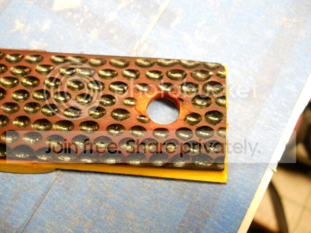

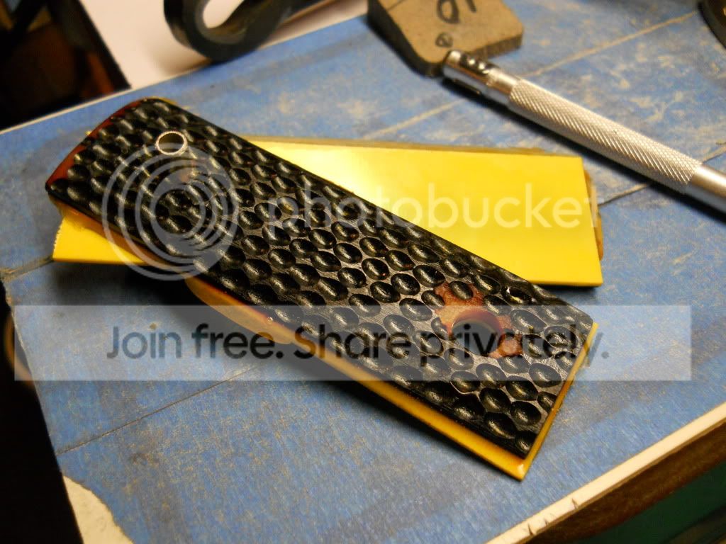

Well, my glue up from last night with the jigged bone scales and G-10 liners worked out great!:thumbup: I started getting them ready tonight after work for installation on the knife. I tried to go slow and smooth, but I had a bad chip out when drilling the larger 3/8" hole for the thong tube:( I sanded it down some and think that a little epoxy during final glue up might be able to help me blend it in. Is this scale save-able? Bone slabs from Culpepper arn't cheap and I'd hate to scrap it.
I haven't worked much with bone, so any ideas from those who have is quite welcome.
Chip out pre sanding:
After a little bit of 150 grit to smooth it out a bit:
Maybe try a countersink/vari bit and make it a dished out area with the thong tube flared?

Just redye it. polish the scale, then build the surface up with super glue. Lightly sand it level, and repolish.

I'll definitely try that too. Can't hurt:thumbup: I think this one will survive with a bit of work. I finished rough shaping the slabs and did my glue up just a bit ago. Tomorrow night I might be doing final handle shaping and then we'll get some pics up. It's a new model and I'm hoping it turns out good.......
