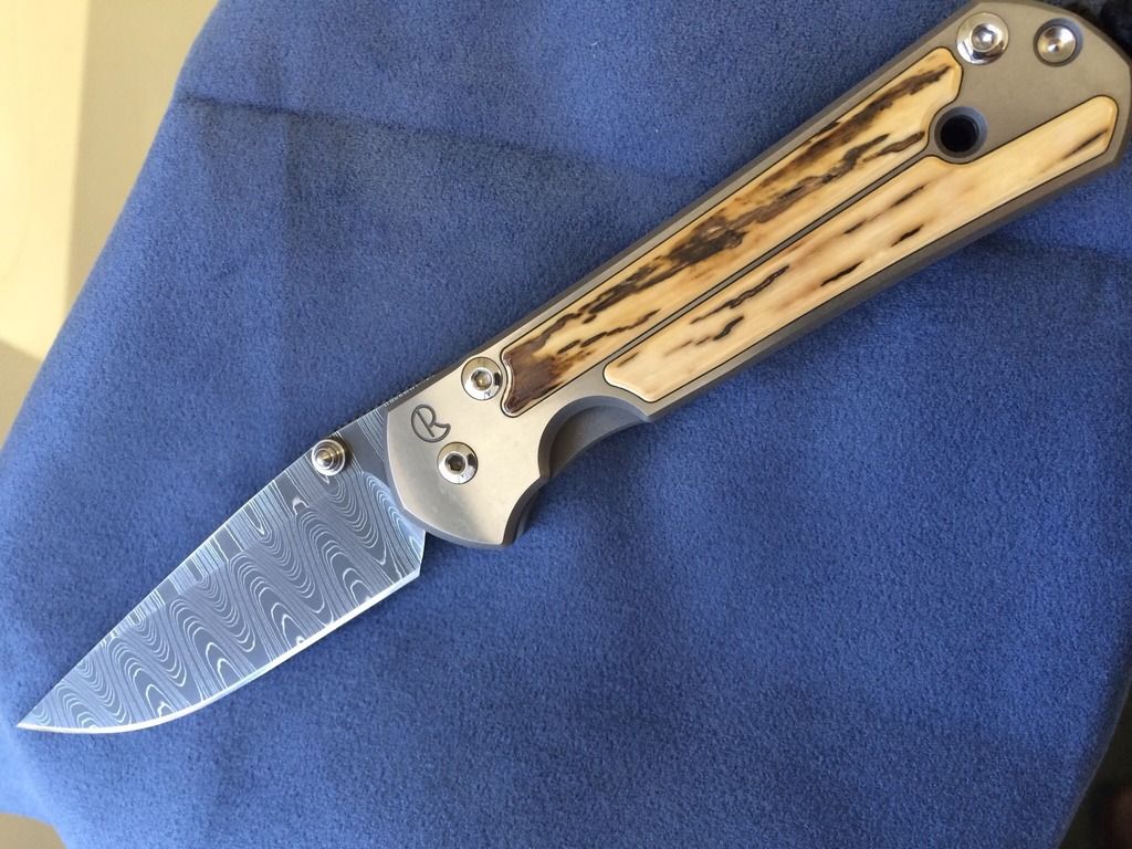

So I bought a beautiful small mammoth bark with ladder damascus 21 a week or so ago and noticed after a few days that there are some apparent chips in the finish over the inlays.
My eyes are drawn to it every time I admire the knife.
The ti handles are in great shape, so it's hard for me to imagine that this was caused in a previous owner's pocket or anything like that.
It's not a huge deal, I guess I'd categorize it as a minor bummer.
I know I'm more than likely SOL with CRK fixing it based on the paperwork received with the knife.
Oh well. :(

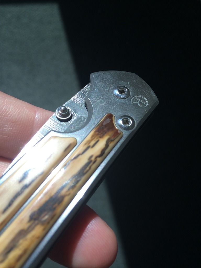

You can see the bigger chip on the left near the screw in this pic.

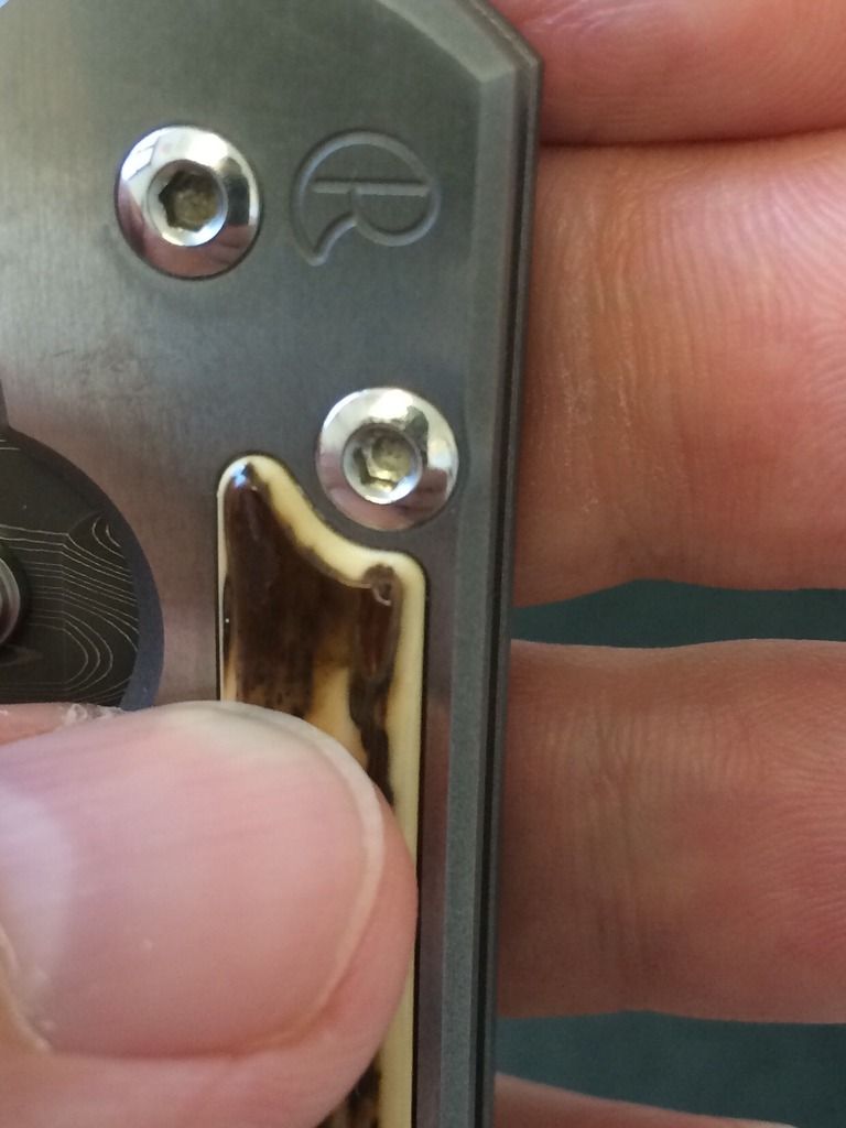

Smaller but deeper chip on the right at the corner in this pic.

The chip on the right is very small, but definitely noticeable.
The one on the left in the first pic is really only noticeable at the right angle. But I know it's there so it bugs me.

I think that this is probably inherent in the nature of the material. It may be possible to polish it at CRK to reduce the chips. Calling them was a good idea.

This is quite common and if you look at most mammoth, especially bark, you will see chips. While I only have one mammoth inlay, I have seen 100's of pics showing such nicks and chips, even from dealers sites that show the new knife. It's a natural material and this is to be expected, especially from a fossilized material. Being as this knife has been passed around, it's quite possible it happened during that time, or it could have been when it was new. Look around at mammoth pics and you will see polished with dull spots and chips, especially with bark. CRK discontinued mammoth because they were unable to find quality pieces to work with. I am sure they have milled many of fine mammoth only to see nicks and chips after machining........Sorry to see this and hear that your upset by it. I think anyone would be to an extent, especially if they did not see it in pics beforehand.
