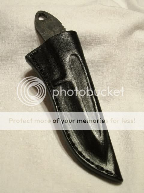

Greetings everybody,
Just finished up the leather on this one. It is O-1 with kind of an unusual cross section. The right side grind is flat down to the edge with a hand scraped fuller above. The left side is hollowed for ease of flattening like on a Sashimi Knife. This can be maintained with water stones the same way you would sharpen a traditional Japanese knife. The handle part was spattered with a resist and etched. It give a nice texture.
There is some truly great work on this forum. I would love to hear your comments.
Cheers,
Nick
