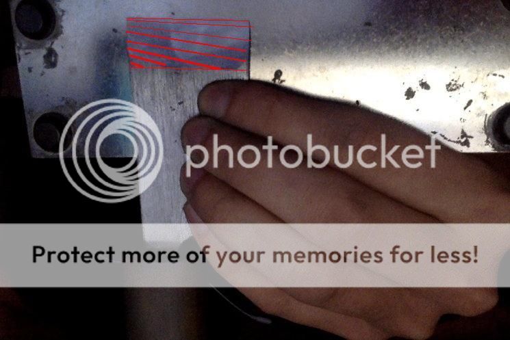

Any inexpensive chisel jigs that you recommend $20 - 40? Needs to sharpen around 8-15 degrees. Easy and consistent to use (clamps tight and rolls smoothly).
What im looking to fix high spots and uneven areas on a chisel edge.

Ugh,
First step is to square off the edge to 90° if that's important (I cannot tell from pic if its on or not - looks close anyway).
Mark up the side that's lagging (left side) and begin grinding from that shoulder transition corner out and across at a diagonal to meet the opposite right side outer corner, assuming you want to match the edge overall to the right hand side.
The right side outer corner/edge will be the last spot on the stone.
It will be a lot more grinding to match the angle to the left side, you'd have to grind all the way back to the existing right hand shoulder transition, but at the more obtuse left hand cutting angle.
The thicker lines are the starting point/most stock removal.
Realistically as long as the lead edge is reasonably square, if the bevel angle is off a few degrees from one corner to the other it won't effect function to any notable degree.
