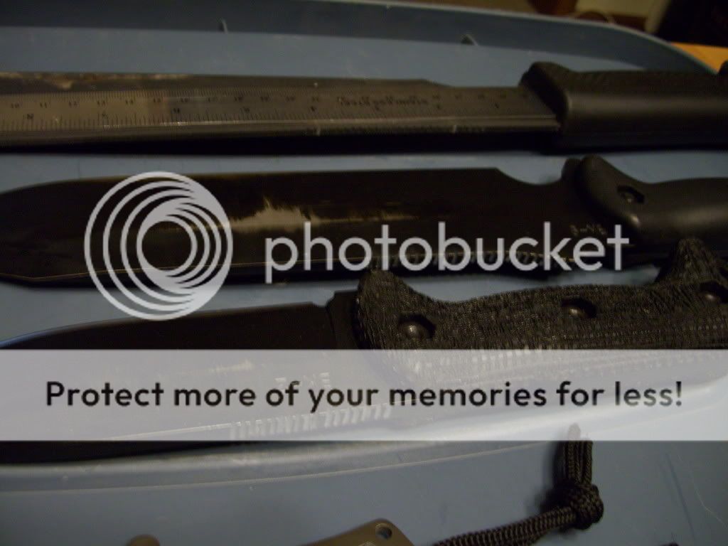

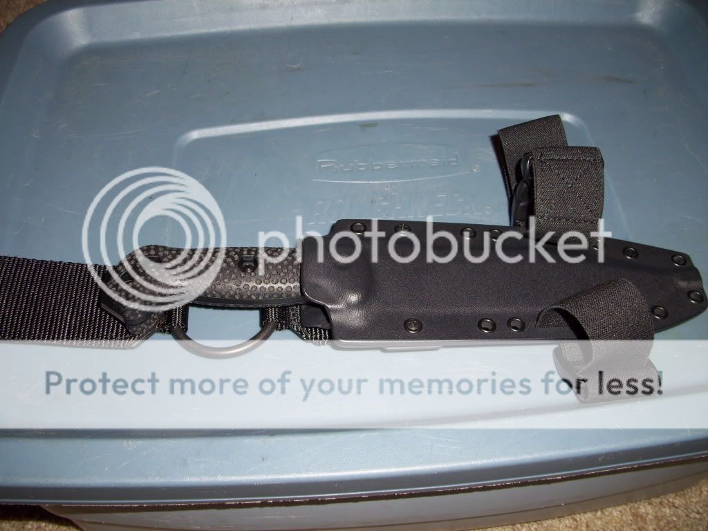

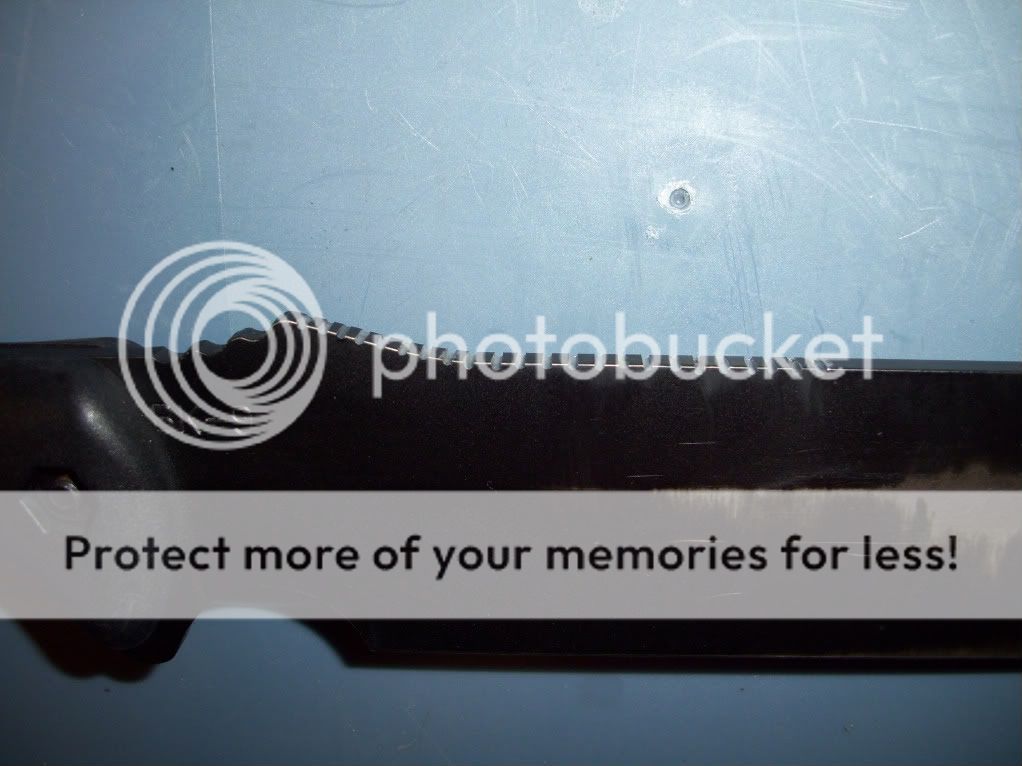

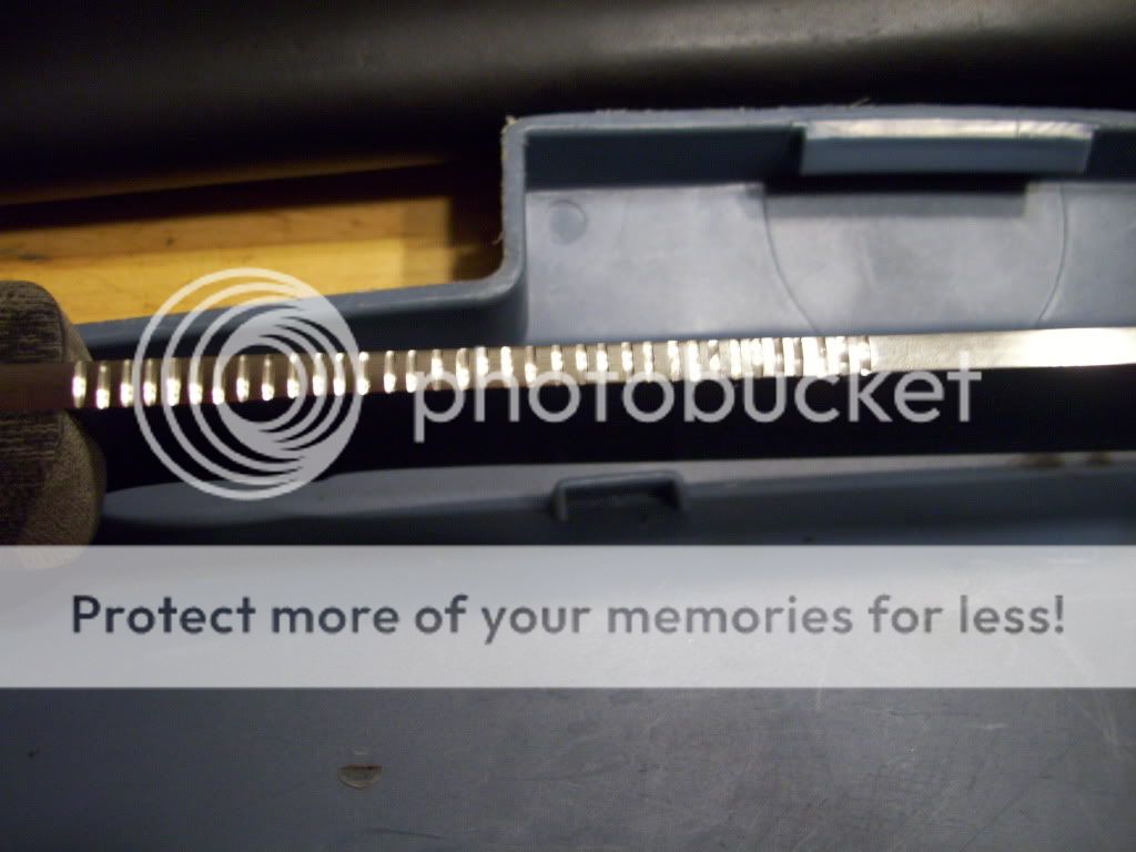

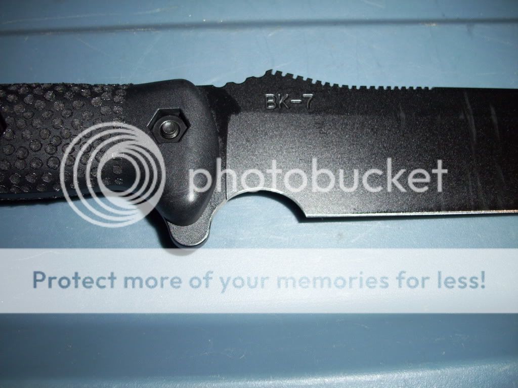

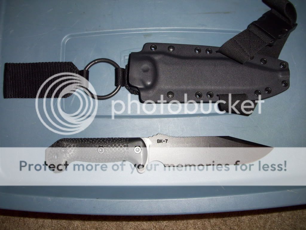

Well, as you know, i recently bought a Dremel 4000 tool & a boatload of accessories, to do modifications to my blades. I am lovin' it bigtime. I will get better with it in time, i have no doubt. I did'nt have the time to do a perfect job, although a few came out really good, but they are ALL super functional. They now have character to be sure & they are the way I want them. So, I jimped the WartHog, 2 Remora BK13's, BK11, BK14, BK2, BK9, Ontario 12" D-handled machete, & my Condor Boomslang. I also choiled the Ontario 12" machete & modified/removed most of the D-handle. So as i said, certainly NOT perfection, but i like them all. The BK2 i started to TRY to jimp with some files quite a while ago, that did NOT have the desired results, so i made them MUCH more functional, but they look kinda bad.
KaBar WartHog-I jimped the thumb ramp & 1 7/8" down the spine.
Remoras were jimped about 1 3/4" down the spine.
BK11 & 14 were jimped about 2 1/4" down the spine.
BK2 was jimped about 1 3/4" down the spine.
BK9 was choiled & jimped about 2 3/4" from high spot in thumb ramp, down the spine.
Condor Boomslang was factory choiled & i jimped it about 3 3/16" down the spine.
I really like the grip now for my thumb. I hope you enjoy. I am REALLY lovin that Ontario machete now. I think i will do it to my 18" bladeed Ontario as well. I used only 1 of the Dremel Easy Loc cutoff wheel to do all the jimping & it is showing almost no wear. I used 1 grinding wheel to do the choil on the BK9 & the machete, it now has quite a groove in it but is still functional.

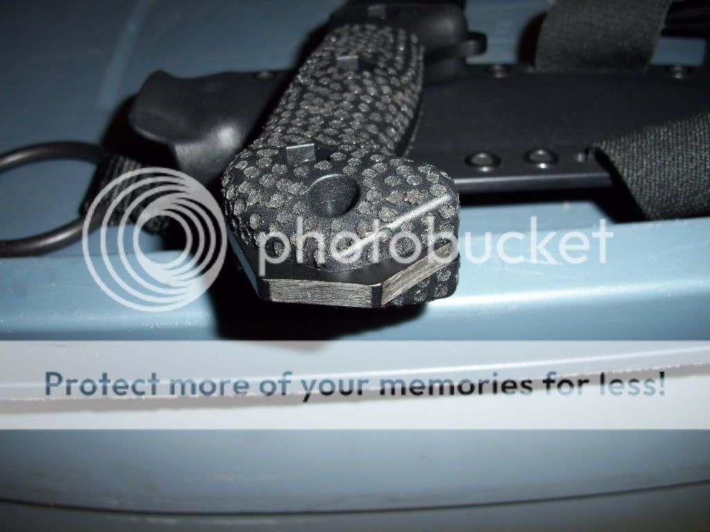

Thanks for all the kind words. I wish i had the money to take them to a machine shop & have them done professionally, but i don't. I really like the 90 degree angle for grip. I tried the small chainsaw sharpening stones on a scrap piece of metal & they did'nt feel that grippy to me.
I love it now. At first i thought the dimples on the handle would be too aggressive, but i was wrong. I REALLY like it. Hurricane Irene could'nt get that sucker to slip outta my hand now.
