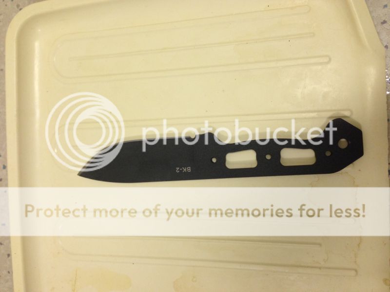

Stripped the scales off...
Let it cook in some citristrip for an hour or so...

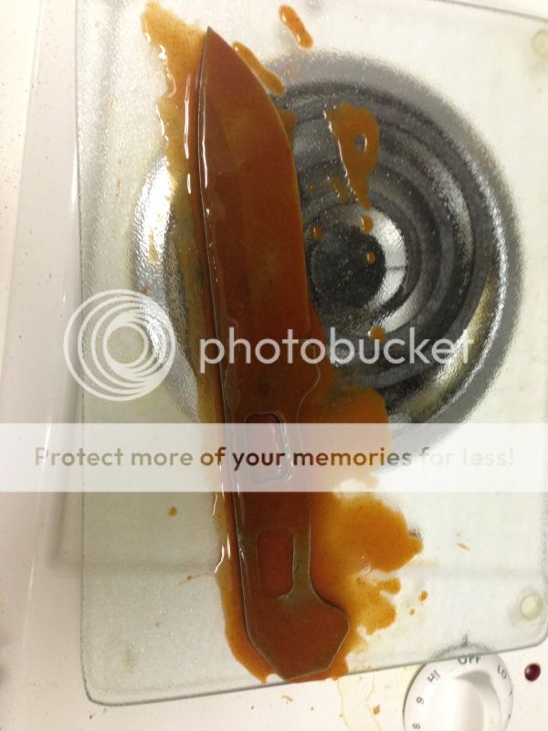

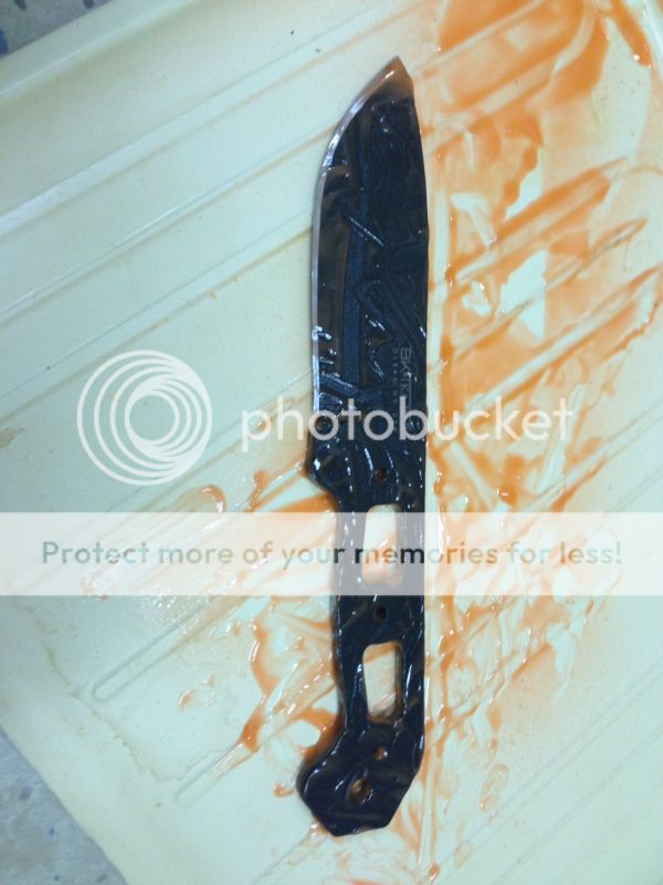

Doused it in cholula for about 20 minutes...

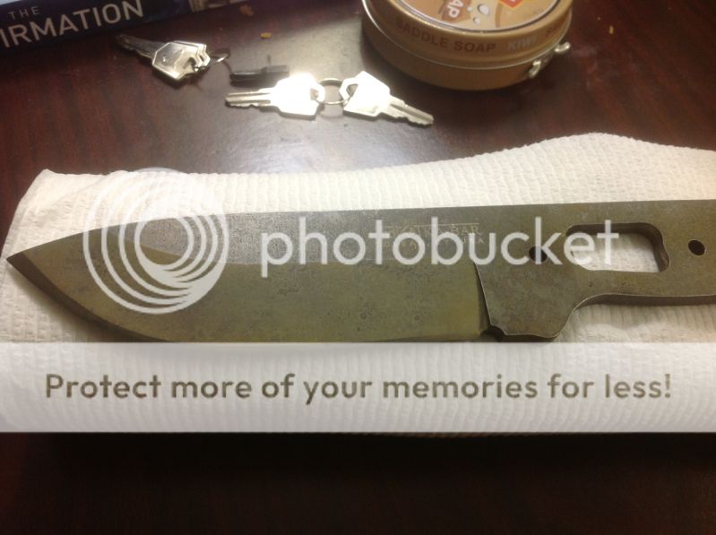

And washed it off...tada!

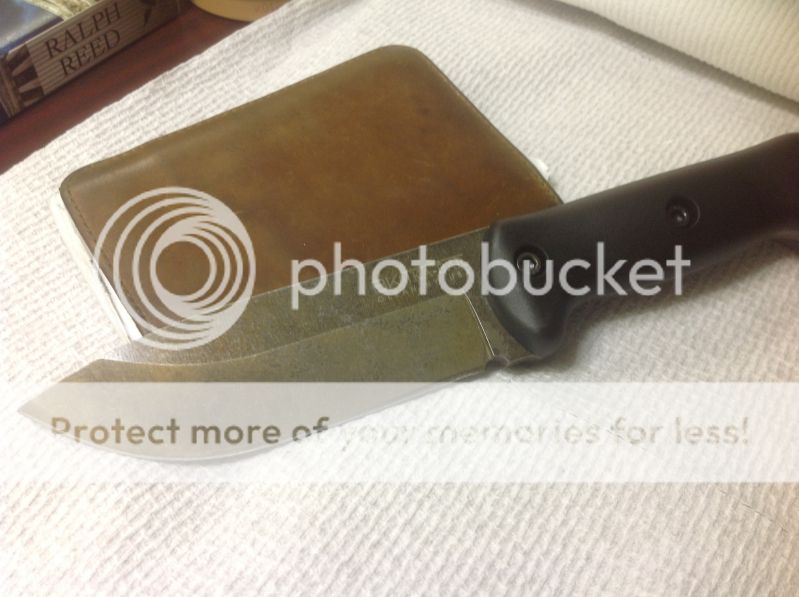

Honed, oiled, and rescaled...
The pics don't do it justice... I am more than happy with the results. I'll take more shots when the sun comes back up!
Yes, i didn't want like how "shallow" the original edge was so I thinned it a little then finished it at ~20 ish degrees
