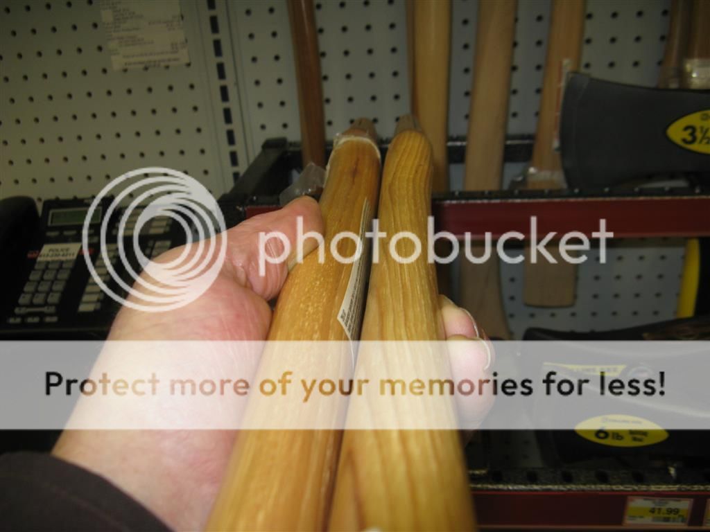

Poking around at two local Home Hardware stores yesterday I came across some lovely examples of what to look for in hafts, and what to avoid. Even when wood grain on a handle is straight a curved profile requires extra precaution.

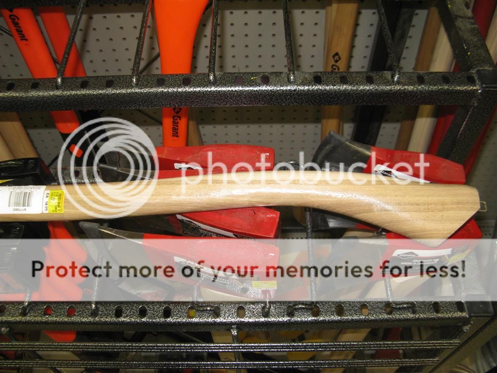

Below on the left is a perfectly suitable end grain oriented haft (#1) and to the right is a 'least desirable' version (#2). As you can see from the following picture (a side view of #2) the grain literally 'runs out' within the curves at both ends of the handle. Longevity and durability of #2 is not going to be very good when subject to striking shock or up or down prying.

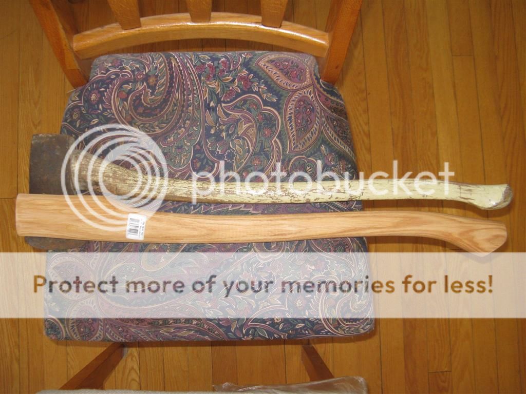

Once you've selected the best of the hafts with regard to end grain (ie versions least like #2) then you begin taking a close look at the lengthwise grain of those handles. First one in the next series of pictures (#3) (which also happens to be a different view of #1) shows ideal grain which is unbroken for the full length of the haft whereas the second one (#4) is by far the most extreme example of grain "runout" that I've ever come across. Breakage due to any directional shock or prying is pretty much a given for #4.
Only reason I photographed these is that examples of 'ideal' and 'horrible' are very rarely found. Haft selection typically involves compromise, that of choosing one with least amount of undesirable traits.
Final picture is illustrative of this. If there were only two handles remaining in the bin the left one (#5) would go home with me and the right one (#6) would stay behind. In fact if #6 was the only choice and I wasn't in a hurry I'd either wait for new stock or go to another store!

So given two handles the one with grain running perpendicular to the bit versus pronounced runout I'm thinking the bad grain would be the better of the two, is that right?
Runout is bad. Grain orientation in the absence of runout is largely a non-issue.

I suppose that either/or, rather than both at once are equally preferable. Horrible run out (such as on #4) is no where near as common as is perpendicular end grain. I have no real interest in performing objective tests in this regard; I've inspected quite a few broken handles (hammers/sledges/shovels/axes/wheelbarrows/paddles) over the past 40 years and have noticed that most of them 'let go' with the grain and not across. On this basis is how I have tried to evaluate what I want to see in an axe handle.

No matter how straight the grain there will be run out on a curved haft if the end grain is perpendicular to the blade.

Couldn't resist; went back to abscond with the earlier featured $9.95 'severe run-out' haft. If someone here is keen on possessing/displaying an educational example of what not to use for an axe handle let me know The unknown company that makes these generally supplies Canadian Home Hardware stores with pretty good stuff. Haft beside it is also one of theirs and is about as nice as it gets with regard to grain.
Buyers of today though no longer have access to the artfully thinned 'springy' hafts of old. The pictured new haft shown, although not 'clumsy thick' such as current Link versions, nevertheless feels and looks 'club-like' compared to a particularly slim and exquisite-contour Walters from long ago.
Mind you there is plenty of wood on one of these new hafts to enable you to shape, trim and contour to suit.

Wow, I'd be pumped to find the one in the bottom pics in a store. That handle seems to have pretty nice shape and enough wood to carve out a very attractive handle. Looks to me like the swell is about as large or larger in all dimensions than your vintage stick pictured along with it. I also like how long the tongue appears to be.
Yeah that looks like a pretty stellar example. And dropping the dimensions is nothing a cabinet scraper wont fix! :D
It's a good illustration that an axe handle could even have the "perfect" orientation of growth rings, as viewed from the knob end, and yet have terrible grain.
