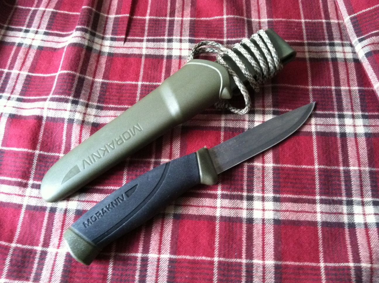

Welcome to the Forum, Desertfox! Don't overlook the Mora Companion - they come in either stainless or carbon and, for $15, you can't go wrong:

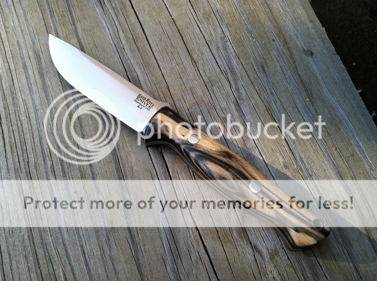

Of course, if you prefer something more elegant (and pricey), Bark River has many attractive offerings - e.g., I just got this Gunny in black and white ebony recently (about the same size as the Mora's, but more than 10x the price):
