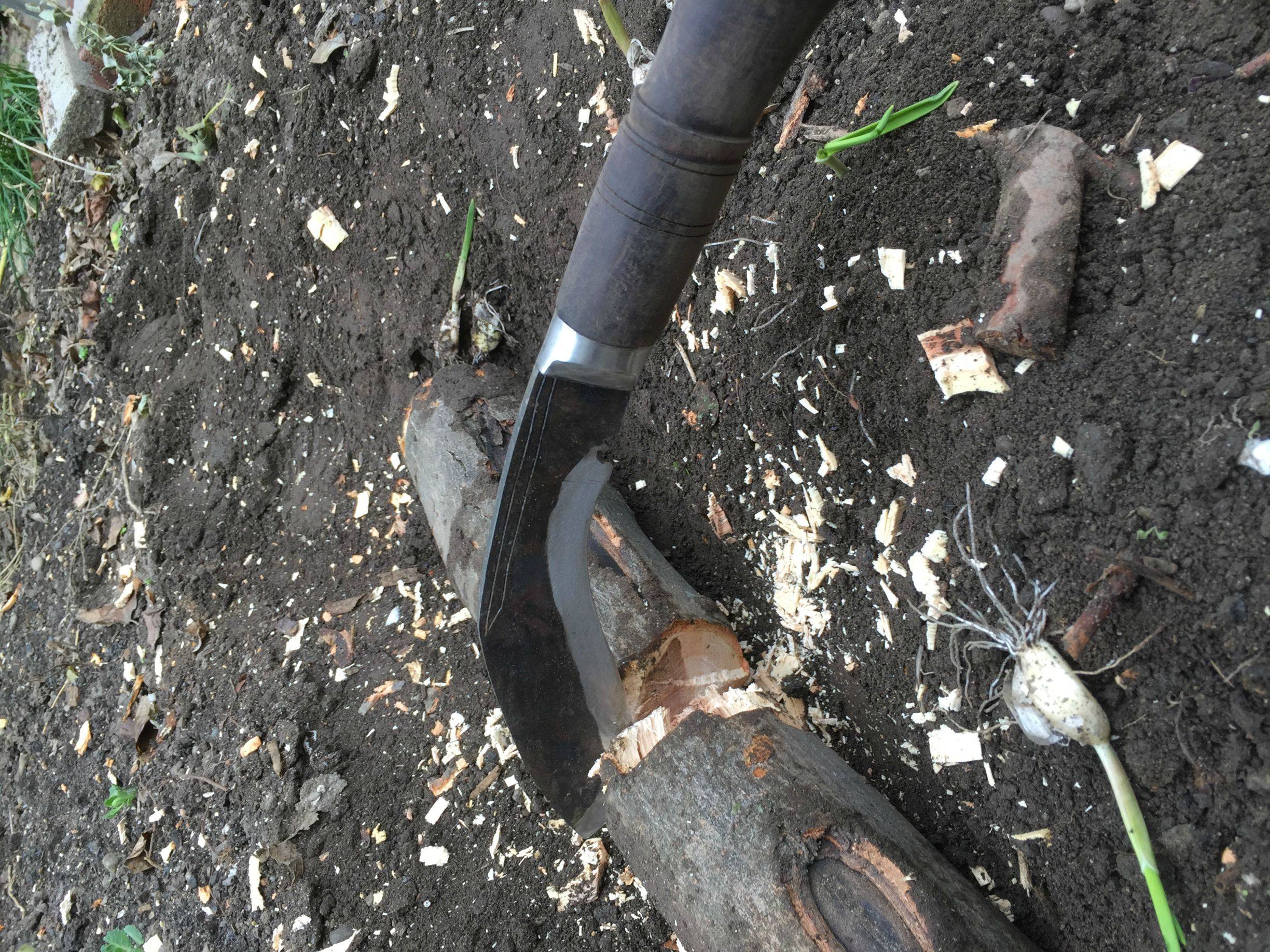

So I had a few questions too... I ended up chopping apart a tree for firewood and it took me a bit. The tree itself was pretty big originally, not as large as one of the last posters but definitely like a 6 inch diameter at some points.
My hand and arm is sore and it took a little bit but the kukri took A LOT. Ha

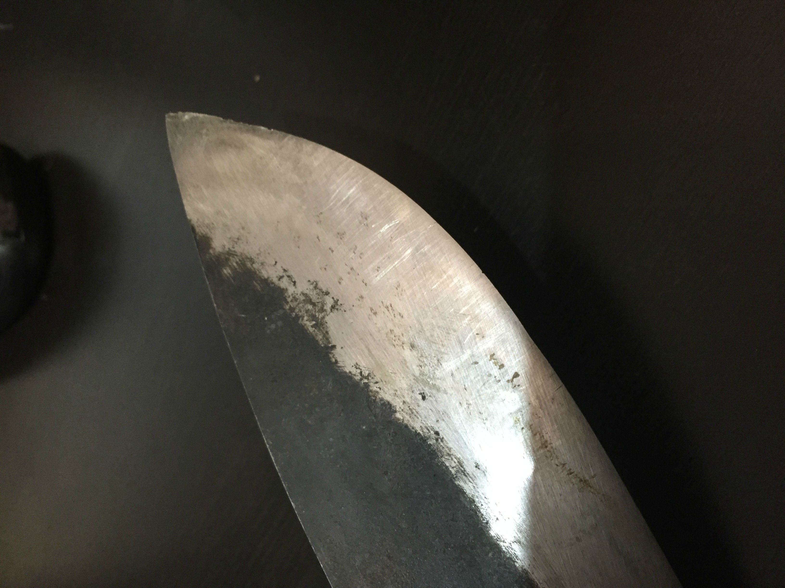

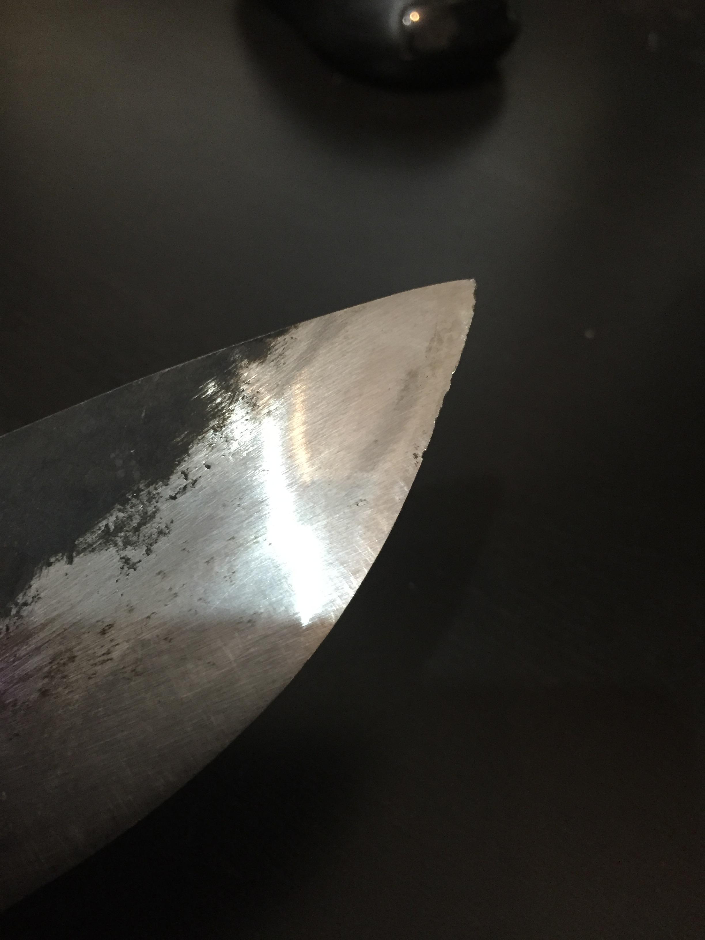

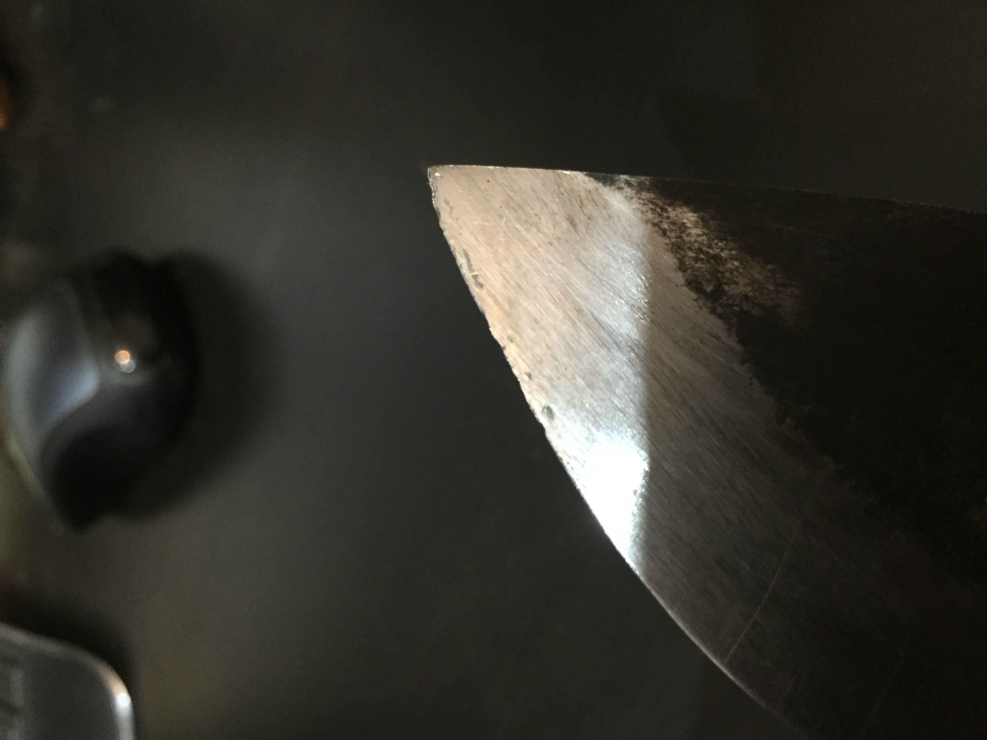

I am a bit of a newbie guy here so in the latter pictures you can see the front of the blade which is looking a little dull, maybe chipped, or something. I don't really know how you would describe it but was hoping someone here in the forum would know or could tell me since Ive seen a lot of posters here with exceptional knowledge. (even on sharpening and maintenance from the Uncle Bill help thread)
the very tip end of the blade is deliberately outside the hardened 'sweet spot' which is further back on the swell of the blade, so is more likely to get dinged on very hard woods, but less likely to snap off of you accidentally hit any rocks or knots. looks like time for the abrasives to touch it up. more worrying, i note a teeny line perpendicular to the edge further back, by the arrow in the cropped photo below. is that just a scratch or does it appear in the same place on the other side? hopefully not as that could be a crack that might propagate. with luck when you touch up the area it will turn out to be a scratch that then disappears. oh, and you should probably try to hit a tad further back than where you have stuck the blade in the log (again, on the centre of the sweet spot). see also This linky on working edges.
These are pretty good questions, I think that from the photo you posted (not sure from which one) it seems to be a scratch, although there are other scratches on the other side, its not a crack from one side to the other.
Thanks for the attention to detail and your time!
When you chop on the ground like that, you are most likely going to get chips in your blade.
It's not a fault of the blade or the heat treat.
I've chipped several khukuri, even ones by the royal kami by chopping to close to the ground and hitting it.
HI khukuri are not warranted for chopping dirt and rocks.
Even if you did not hit the ground, there is also dirt that is stuck to the wood and going through that can cause your blade damage. Just sharpen it out and you will be fine :)
Like the other guys said. It appears your hitting the ground with the tip while chopping. Throw a log under the piece your chopping to raise it up and that should save your tip.

I tried to mainly hit with the hardest part of the blade, but after a bit I get pretty tired and I started missing with it (clearly)...
also... what is this... proper chopping style?

The idea is to let the blade do most of the work rather than holding the handle in a death grip and using arm power. A kind of snapping motion.
I'm not the best person to describe proper chopping style with a khukuri, but probably the most common newcomer mistake is to grip the handle too tightly and swing too hard. That could explain your hand or arm getting tired. The khukuri in the photo seems like a KLVUK model, which usually are not too heavy, so technique might explain the tiredness, which in turn leads to mis-hits.
Also based on the photo it looks like you were chopping at right angles to the trunk, which requires more force to get good penetration. I think it's best to come in at more of an angle so the blade isn't hitting totally across the grain.
